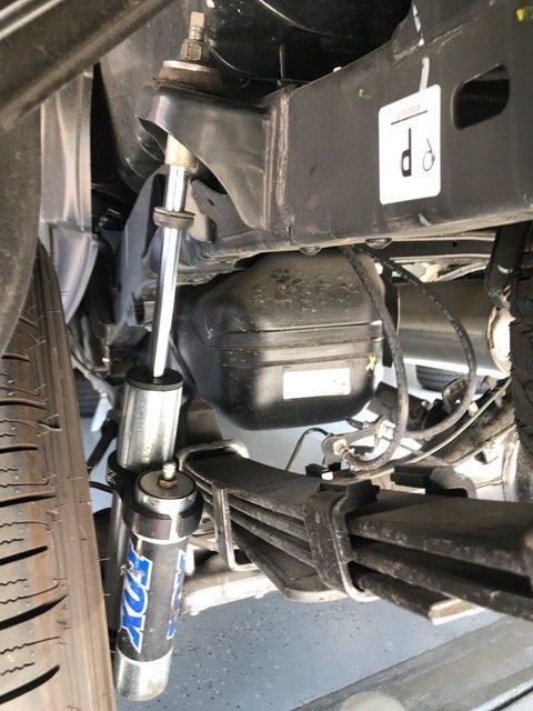

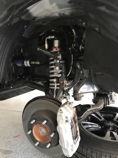

    hi I have fox suspension and just put on new wheels and tires. old set up was a 285/70/17 and now have 295/75/16. my question is can i lower the back 1inch to get i guess that "baja" truck stance were it sits lower in the rear? front coils are maxed out and with the old tires i had that stance but now it looks level.

    What are you running out back?

    fox 2.0 or 2.5 you can see it in the second pic

    got any rear blocks?

    no rear blocks

    remove one of the leafs

    shackle flip kit too

    Pull the overload leaf?

    If you are 2wd / Prerunner get 4” lift spindles, you can’t really go any lower in the rear.
    Lift spindles and adjust he coilovers to the desired amount of lean

    Or, go SUA and buy a custom leaf pack that fits factory hangers, and lowers the truck.

    so i can just remove the bottom leaf spring (small one)? sorry i know i sound like a noob but coming from owning nothing but imports mostly evos and sti's this is a bit different

    Idk how it could be level if you have your coil overs maxed out in the front and stock leaf springs in the back. You must have a add-a-leaf. If you take that out it will lower it an inch or so.

    removing the overload (small one on the bottom of the stack) should drop the rear about 3/4 of an inch. don't expect to haul much after the fact though.
