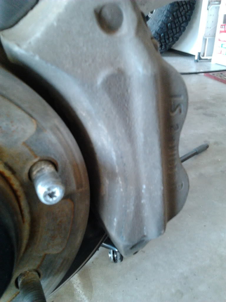

    for the spokes to get in the way they would have to go backwards (in) torwards the truck, because the caliper sits behind the plane where the studs are

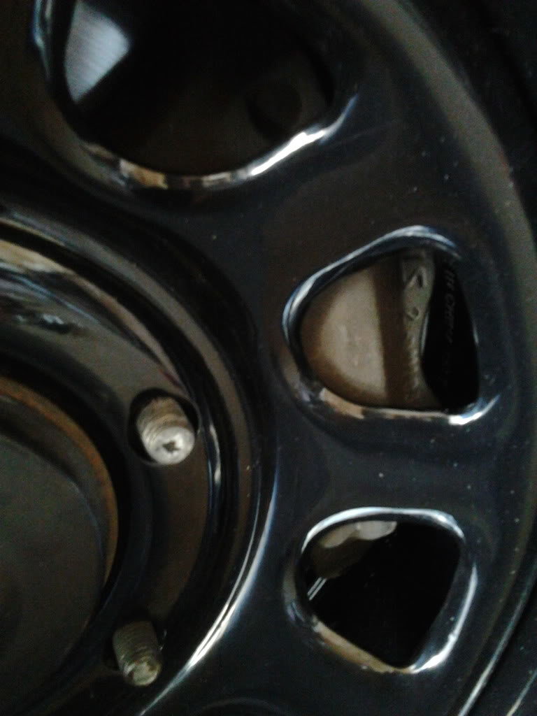

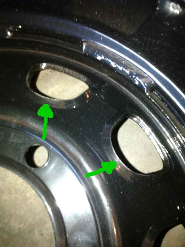

    This.
    The way some are manufactured, there is a lip on the backside that will rub the calipers unless there are wheel spacers. I bought a wheel and tested it out on Pyroskier's truck specifically to check this issue out. :D
    You can see the black mark where it rubbed
