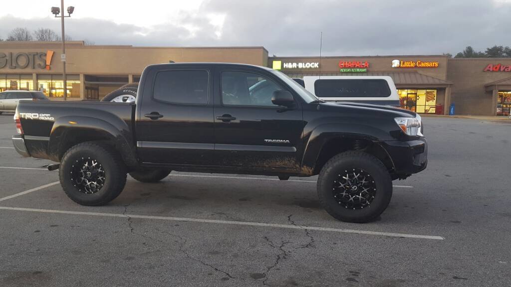

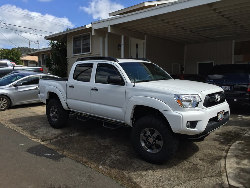

    I fit 285/75/16 with a 3in lift ,2015 TRD Off-Road 4x4, bilstein 5100 4 corners , ome 887 coils , toytec boss progressive aal , rims fj Trd special edition 16x7.5 with 4.5 back space. No rubbing while driving on street or while off road [sand ,really bad uneven dirt road to fishing spots ] tho I haven't took my truck heavy off road like rock crawling yet. Did have to pull off the front mud flaps

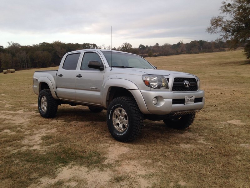

    I fit 285/75/16 bfg mud terrains on my Tacoma with just a 2" lift from rough country, 2" blocks on the back and coil spacers on the front, mounted them to stock wheels and put 1.5" wheel spacers. I had to do some trimming on the front and back fender well and remove the mud flaps but it turned out pretty nice.

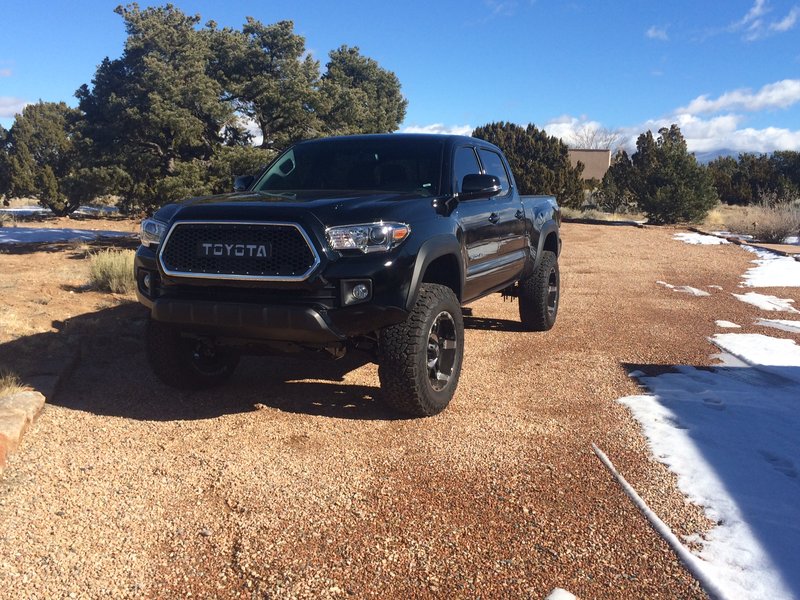

    Stage 4 Icon (650 lb coils, aal) 295/70/17 Goodyear Wrangler Duratrac SCS F5 17x8.5 RCI Offroad bedrack Tepui 2 person Rooftent Caliraised Bed stiffners Previous set up: 265/75/16 Ko2 AT Fuel Anza 16x8
    [​IMG] This is my 2017 TRD OR with Icon stage 4 (aal).
    I’m running 265/75/16 Ko2 a/t. Most people here are posting their 285s, wanted you to see what 265s look like lol
    Also, 285s will defintely make your truck look taller since they raise your axle.
