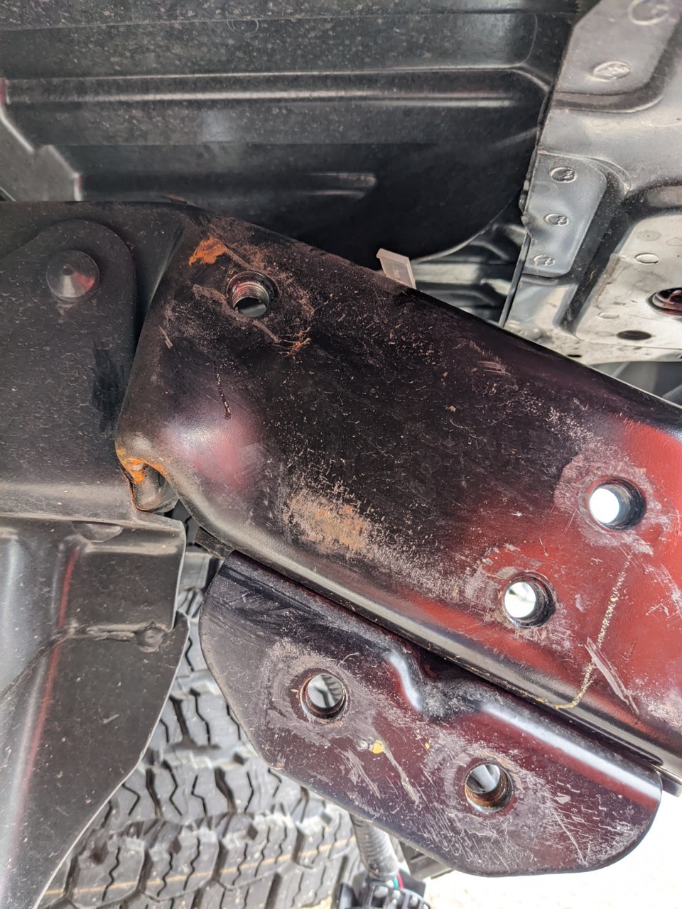

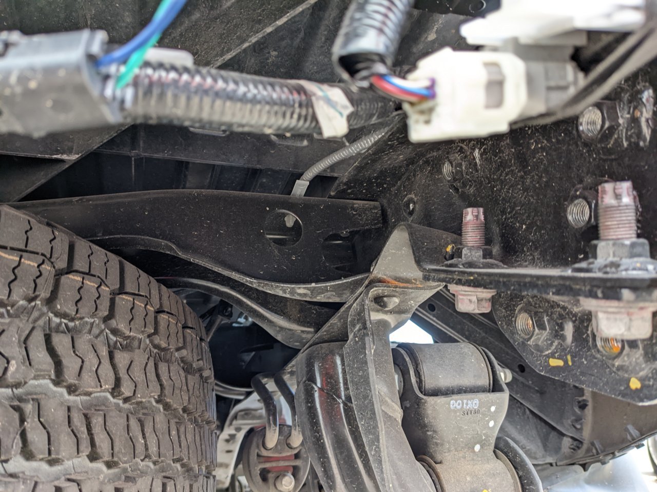

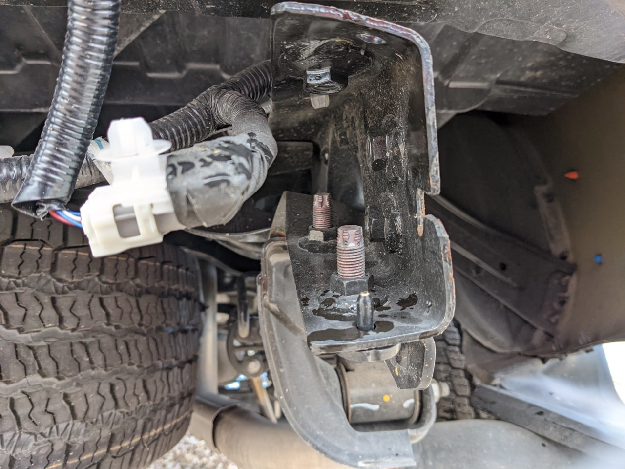

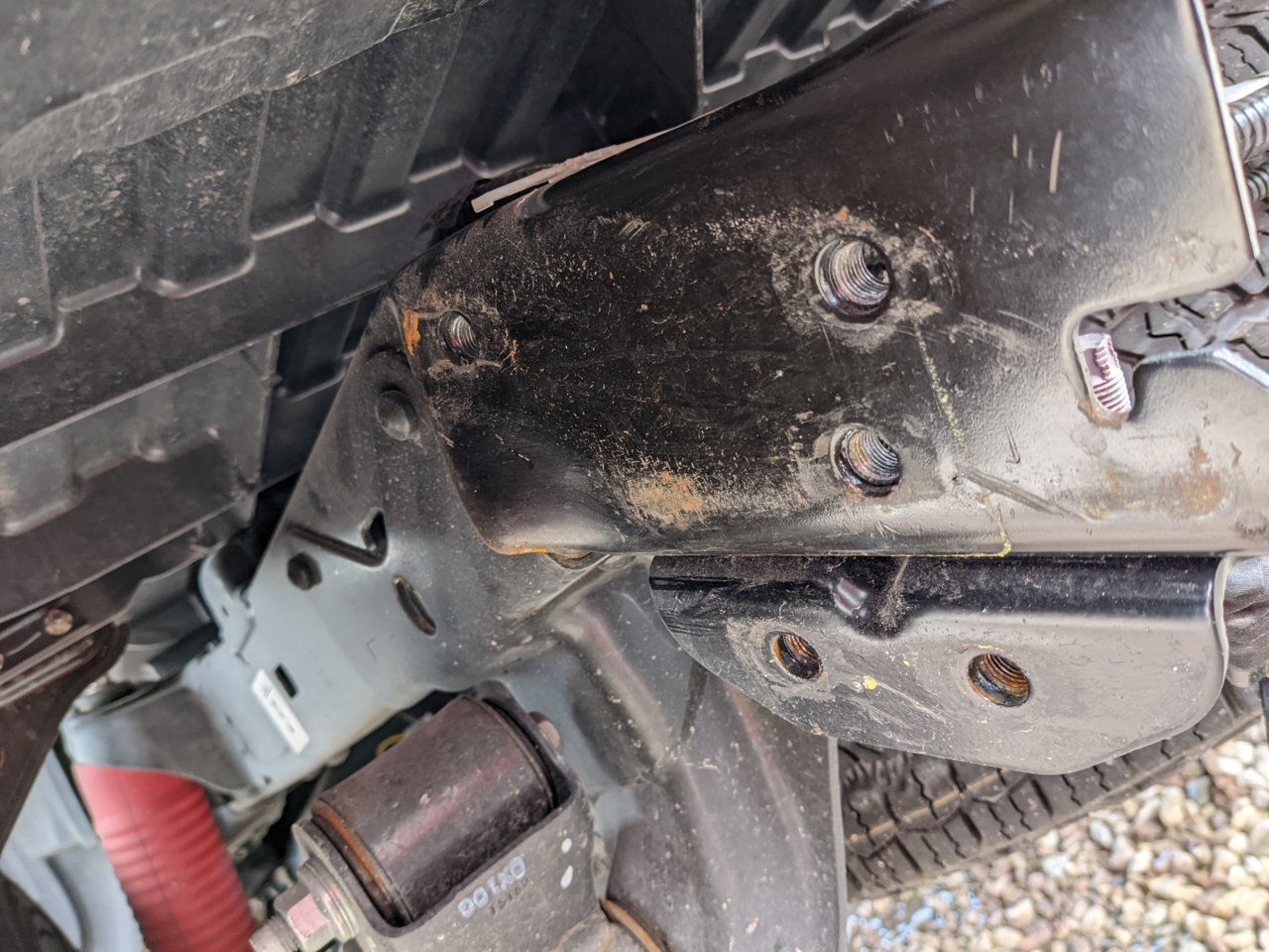

    Hi, I was rear ended and noticed I have frame now on my 2021 Toyota Tacoma TRD Pro. I wanted to get some advice as to whether or not this damage can be fixed? Thank You!

    Looks like it would need a new frame rail.

    A new rail will fix it right up.

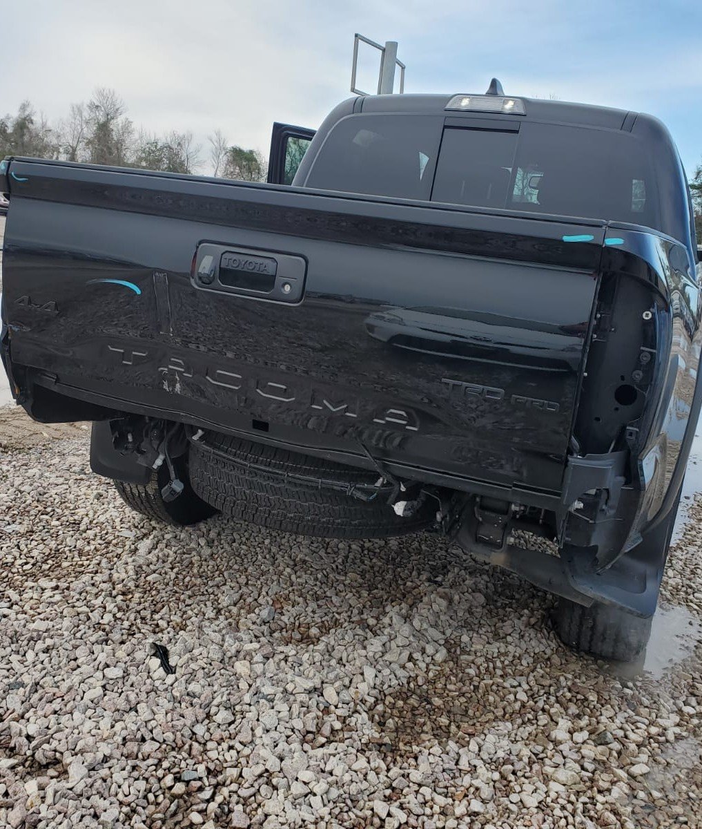

    What’s the bed look like

    Sure, this is how the bed looks like

    It all depends on how interested you are in doing the approved repair or just getting it back on the road.
    Toyota says you would need to replace the frame, but the cheapskate in me would remove the bed and using chains and a portapower I would straighten the frame back up.
    Repairing that frame is not recommended due to loss in rigidity, but it can be done. If you have inspections after repairs then you will probably need to replace the frame to clear.

    Crumple zones my good friend. Thats one of the reasons why I would repair it, a crumple zone will crumple again after being fixed, sure it will crumple faster, but the amount it crumples faster is very small. I do wish the rear had a crumple zone thats replaceable like the front (aluminum bumper under the cover).
    Old BMWs actually had shocks in the bumpers, so in a impact the frame would be perfectly fine (up to 30mph I think it was), then you just replace the shocks and repair the bumpers if there was any damage to it.

    Judging by the blue paint marker on the tailgate this is probably a totaled truck purchased from auction.
