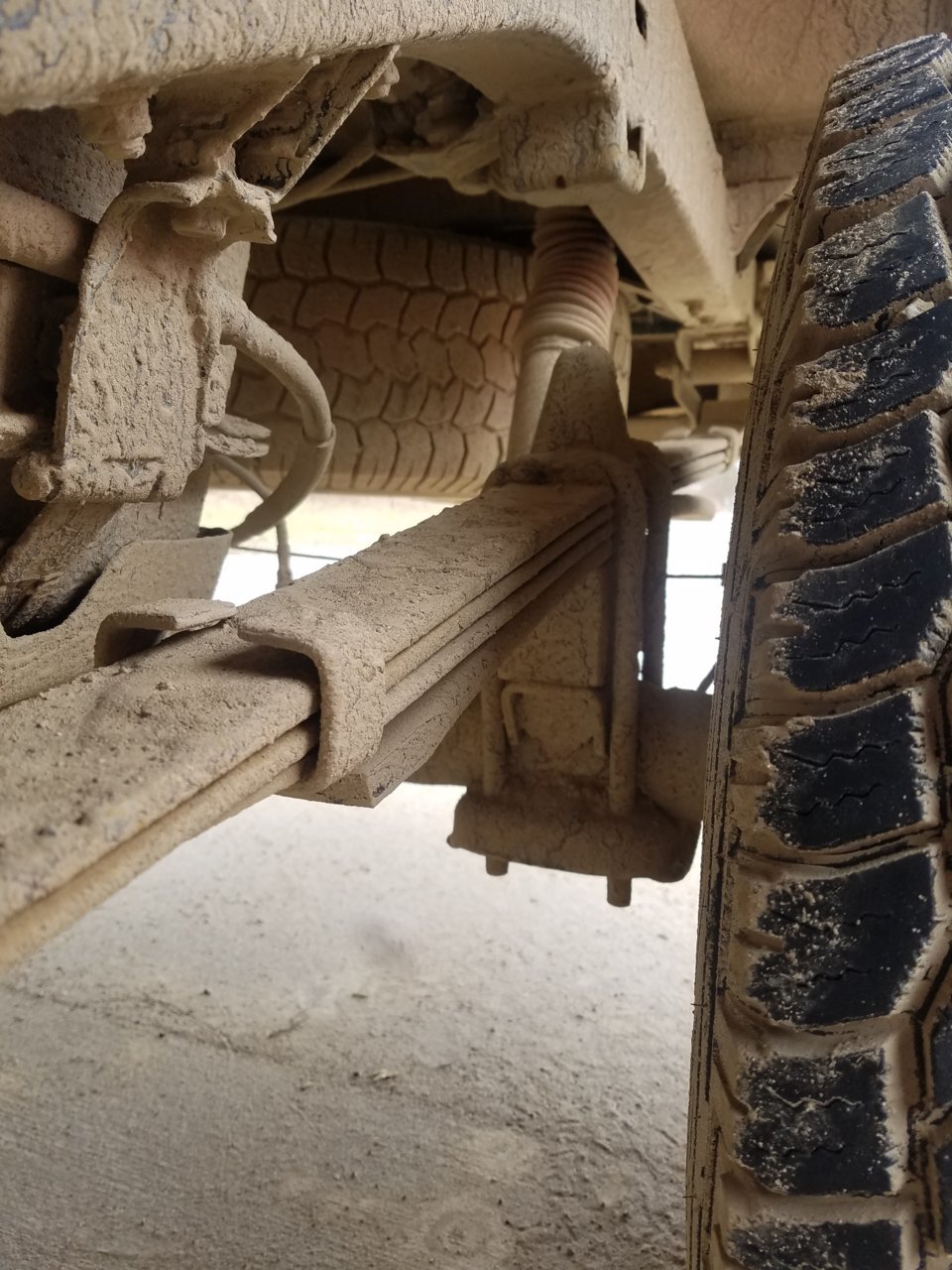

    yes I know shes dirty, but I was looking into getting an RTT for my 95 taco. Talked to a buddy about welding me a bed rack to put it on but It was suggested to get an aal. with my setup could I flip my leaf springs and achieve the same thing?

    You need new leaf springs my friend. Those are shot

    Easy answer no you cant flip them and like desertrunner said those are shot and you need new ones especially if you want to run a rtt.

    So they arent upside down?

    Technically no. But the arch is. Once they start to frown like that there is not a whole lot you can do. Even getting them rearched would cost about the same as a new set

    Okay so say I buy new leaf springs, would I flip my arch to get that extra support for an RTT?

    They only go on one way. Low point down. Get a set of dakars and you'll never have to worry about it.

    Like others have said- they’re shot! Sort of looks like you’ve got a block in there too? If so get rid of that too! It a matter of time before those things break. There’s lots of options out there Alcan, general, Deaver ect.

    The block, is part of the suspension lift I presume? If I remove said block and throw these in With 2.25" of lift from these guys where would that leave my back end if my arch is upside down right now?

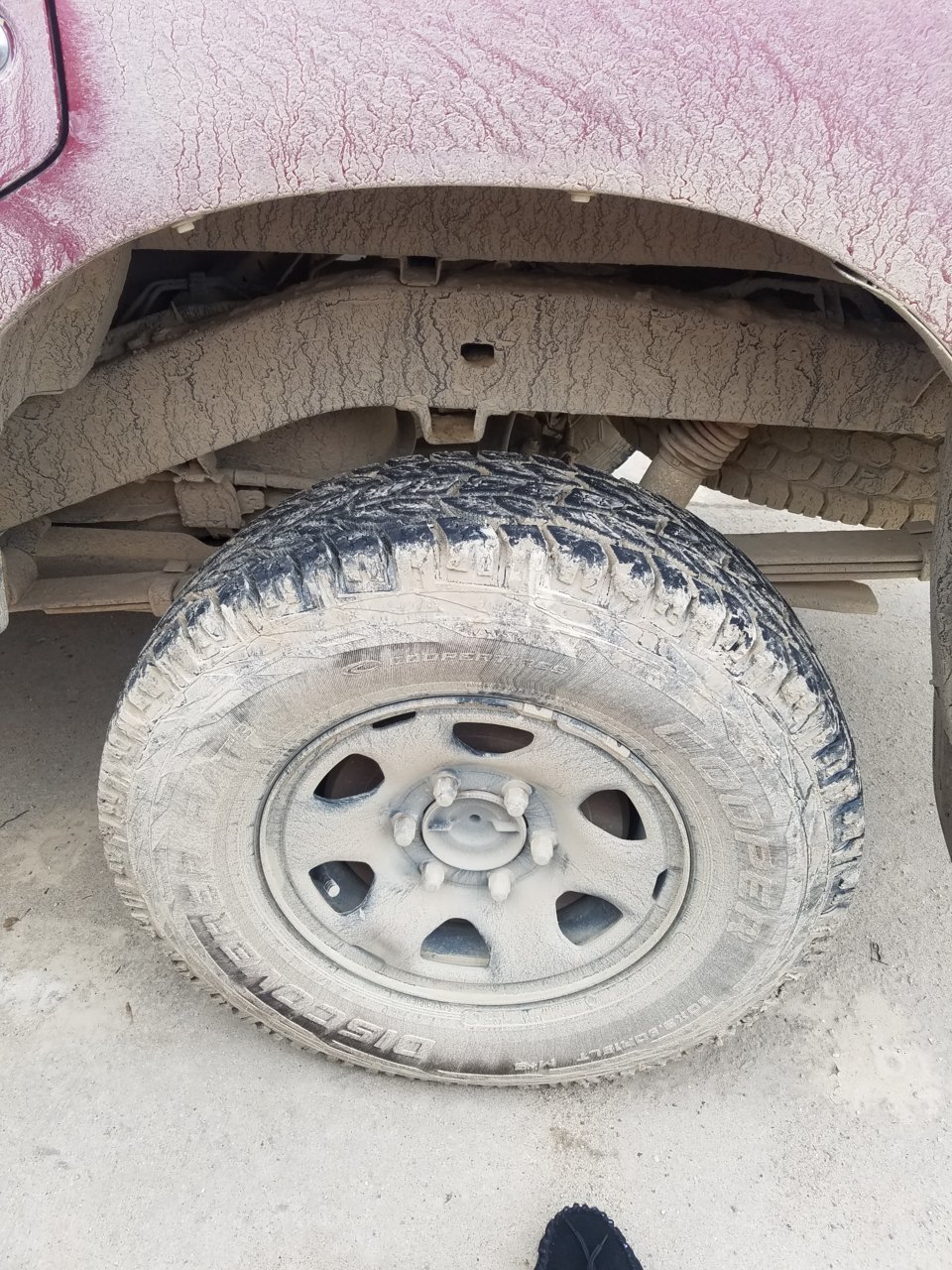

    Kinda yeah. Do you have a side shot of your truck do we can see how bad the bro lean is. But in all seriousness it looks like you have a 3" block in the back. If you go with the dakars you'll be at 2.25" of lift over stock which is about where you sit currently

    Bro lean? Lol again I apologize not very well versed. As in front end vs back end?

    Okay I dont have a side picture but I know the truck sits level or at least is supposed to lol
