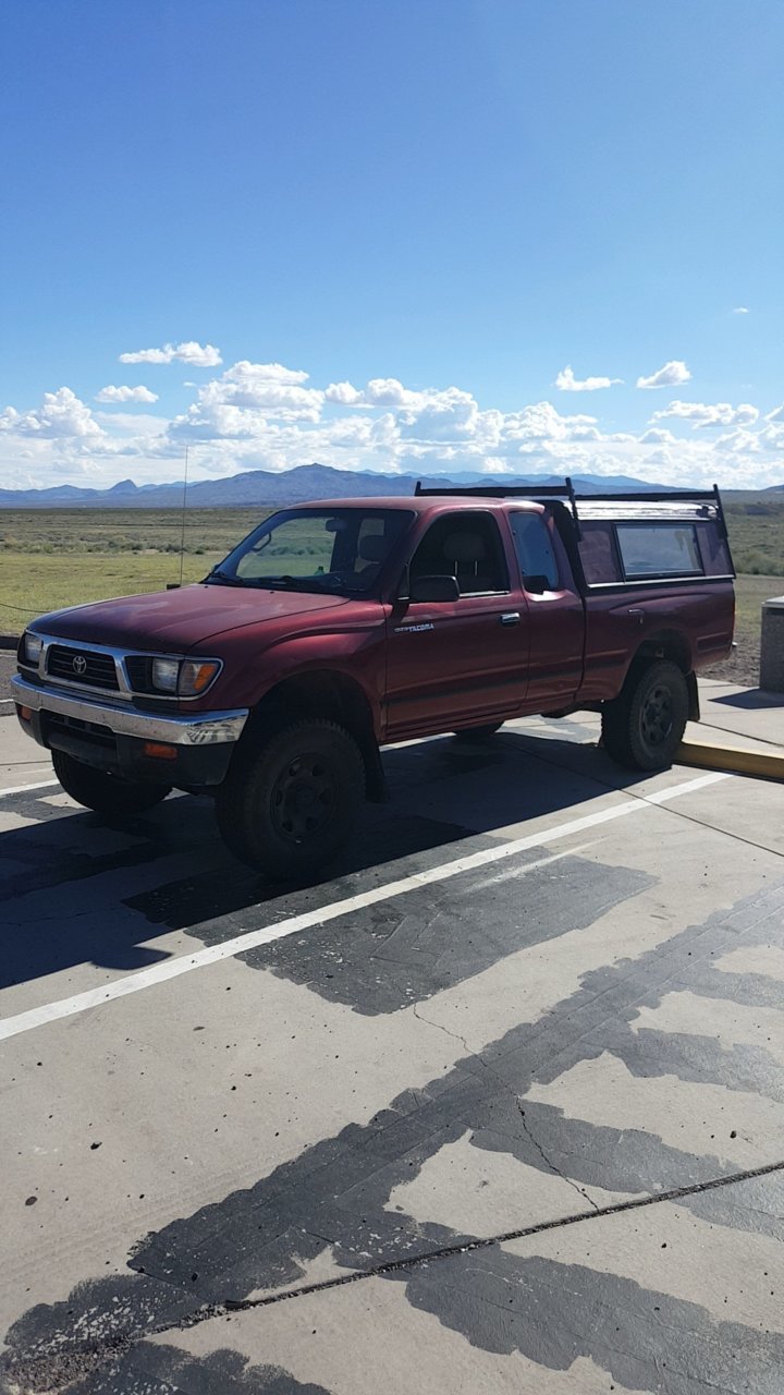

    Call a wrecking yard, check Craig's, Let go, etc. Get a set of 6 lug Tacoma leafs springs (years 95.5 - 97) Then also get a set of Tacoma 5 lug (2wd) leaf springs (from a 95.5 - 97). And buy a Wheelers Off Road 1.5 inch Add A Leaf. (Toyota changed the length of the leafs after 97 so you need to get pre-97 leafs)
    Take the 6 lug leafs apart.
    Take 5 lug leafs apart.
    Put middle leaf of 5 lug leaf pack in your 6 lug pack just under the top spring.
    Then add the Wheelers AAL between bottom leaf and overload leaf.
    (You'll need longer U-bolts and center pin from Wheelers too)
    This is the lift you get... I'm running 285/70R17. I got nearly 3 inches of lift. And they DO NOT sag.

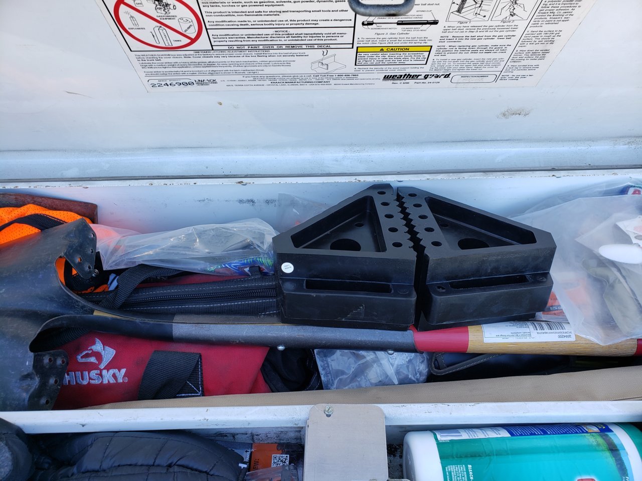

    This is what I carry in my Passenger side box

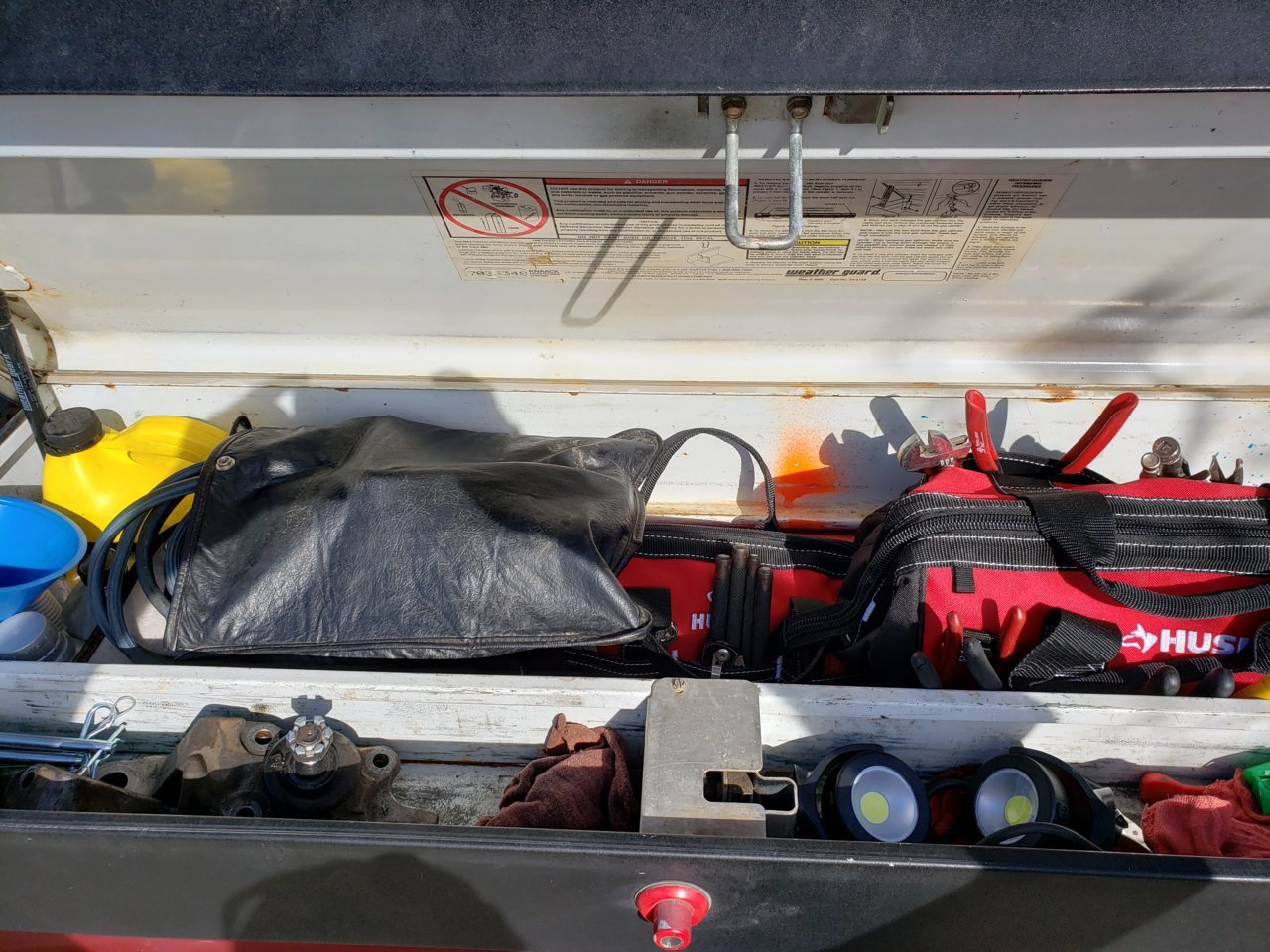

    This is what is in the driver side

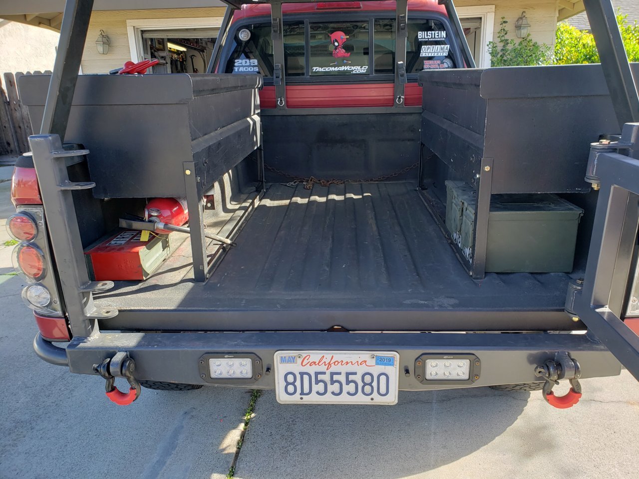

    This is the bed
    I could literally chop a tree down, drag it out of the way, dig your truck out of a hole and then completely part it out to the frame, with what I carry in my boxes... And as you can see... It doesn't sag.
