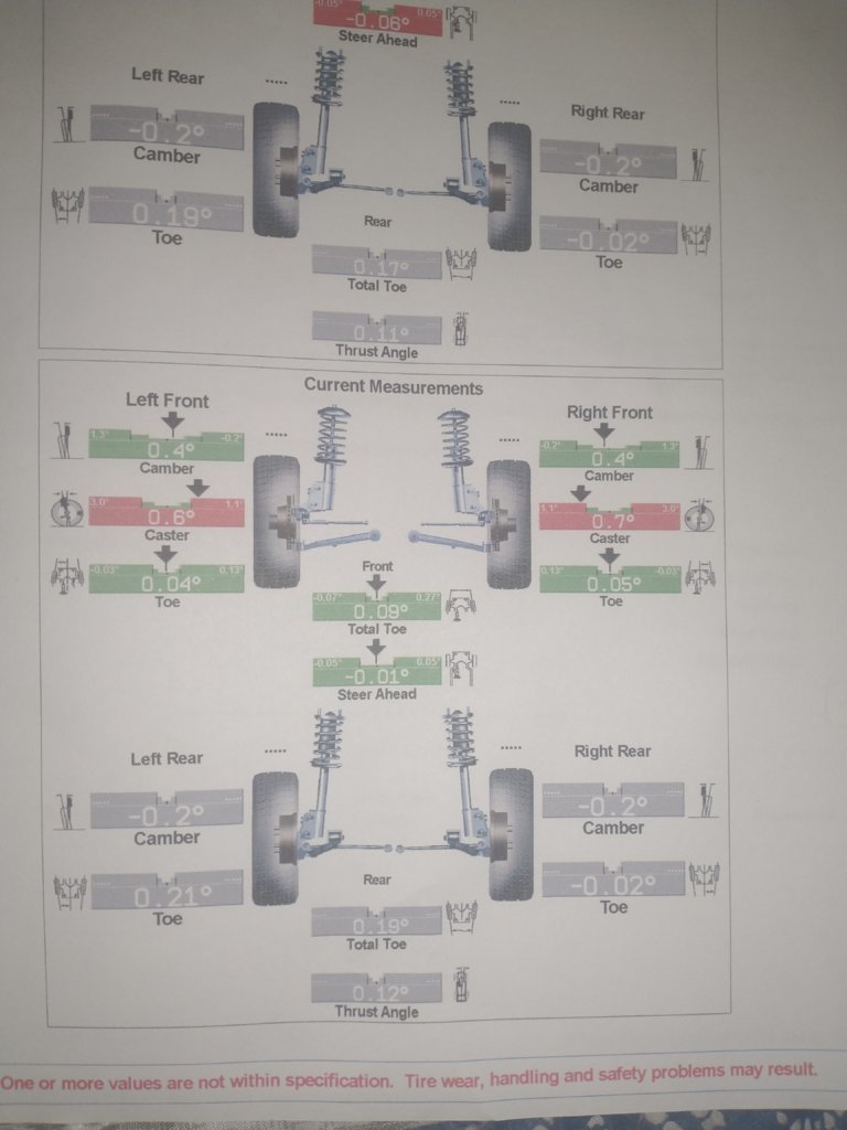

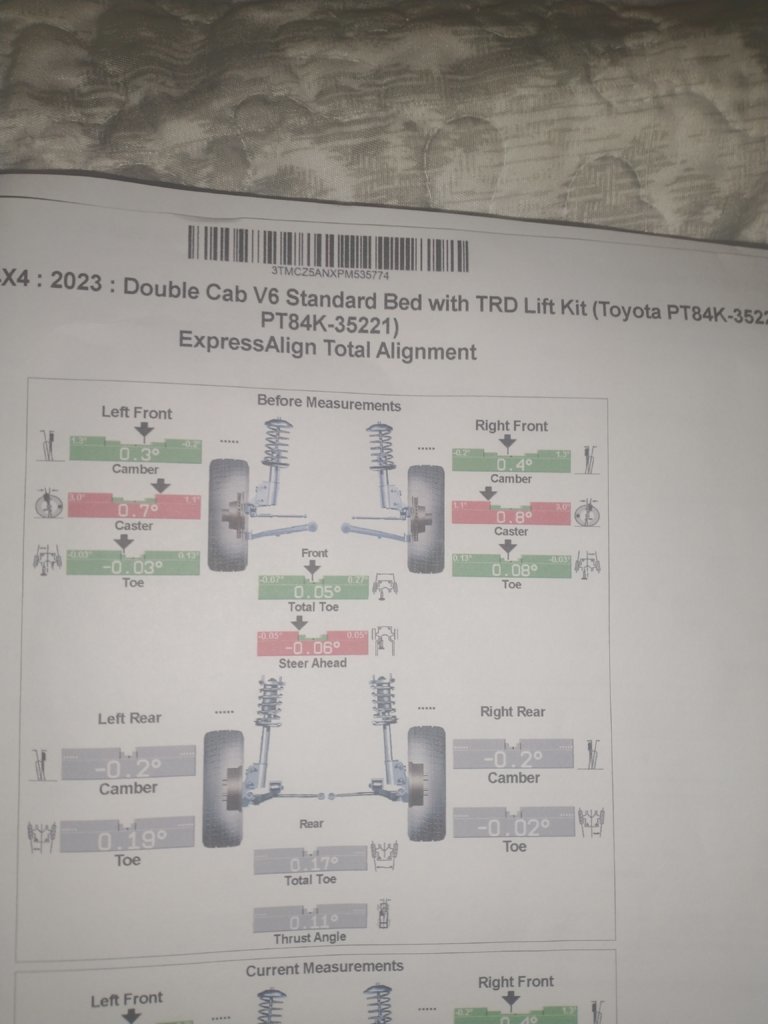

    Scrubbed some tires, and knocked a dent out.
    Installed suspension. Haven't upgraded tires yet. Did 6112/5160. Stock uca.

    Front tires seem to be almost turning in at the "toe"/ bottom when I look at the truck.

    They made no effort to increase caster.
    Next time tell them to max caster, let the camber climb a bit.
    Maybe find a better shop.

    Asked them if they had experience in such things and was of course told yes. Guy at the desk said they couldn't get it all the way due to setting limitations. From what I've understood from here it should be possible.
    Definitely gonna just go to a better place. Appreciate the input.
