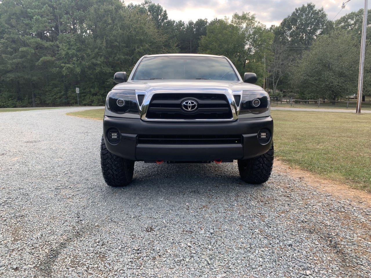

    Just do a retrofit. I have no more than 150$ in these with eBay projectors.
