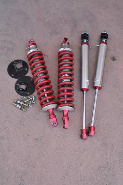

    Im not really sure what they are cuz they came with the truck and the seller didn't know anything about them either. Apparently the first owner put them on. The coils look like this though.

    those are the older 2.0s like i have. the newer 2.5s have the integrated top plate and look like the SAWs.
