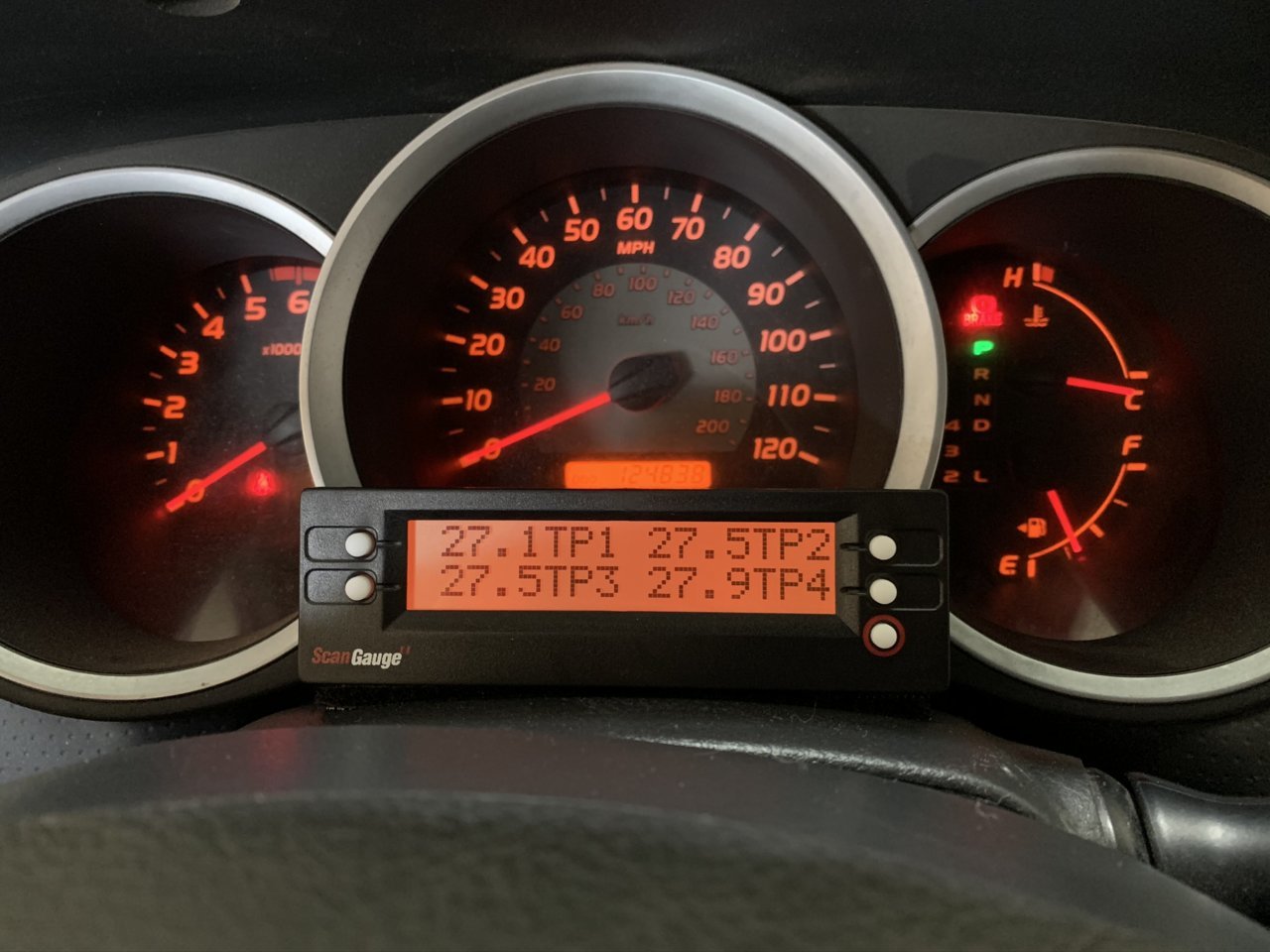

    I can confirm the newer ScanGaugeII will read the TPMS live with the correctly configured PIDs. I got my ScanGaugeII two years ago.

    So ScanGauge uses a system called XGauges which I’m hoping isn’t proprietary but there’s a good chance it is. I used their websites list of configs:
    https://www.scangauge.com/toyota-tpms-method-1/

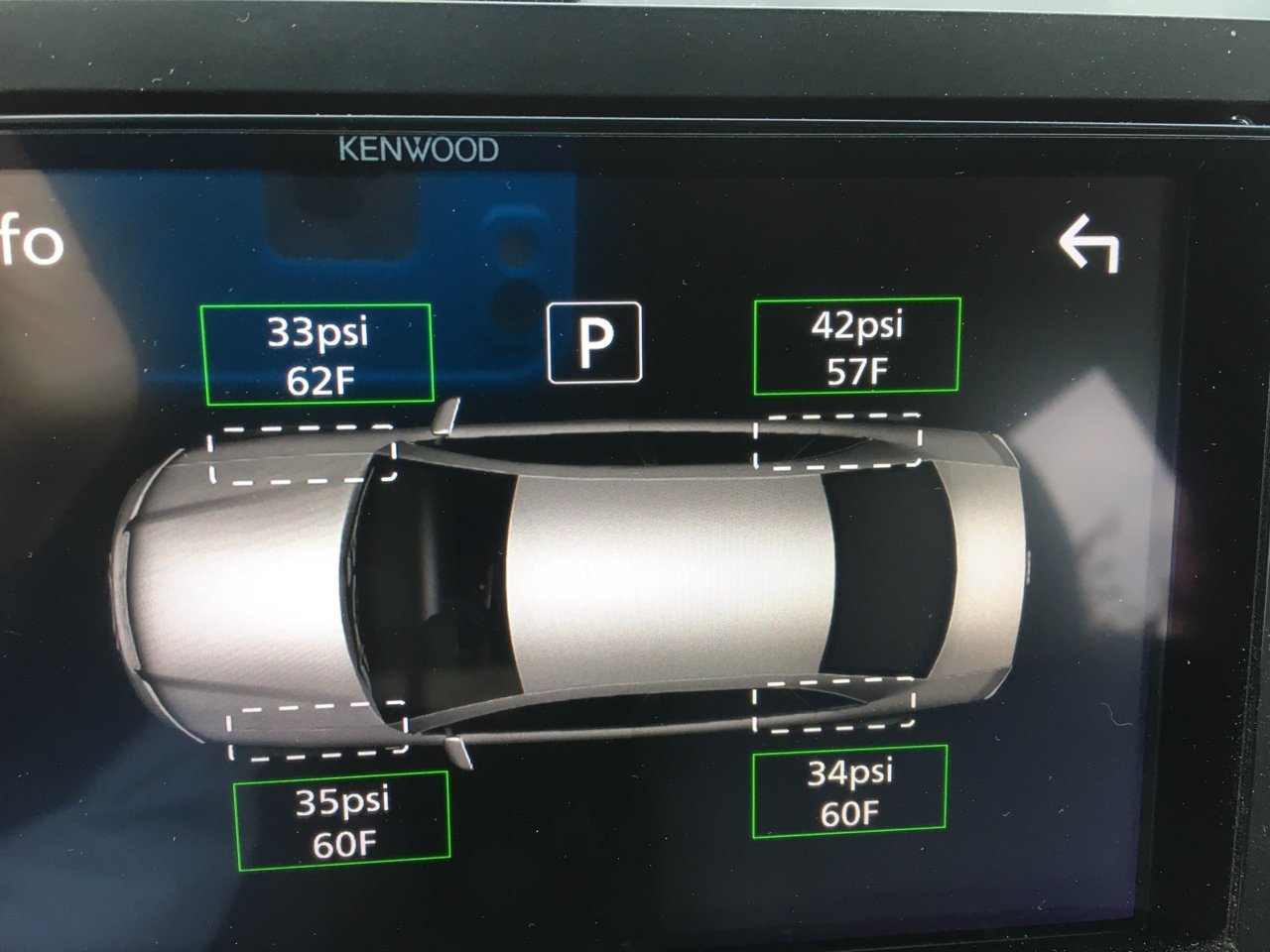

    On my 2014 tC I swapped out the headunit and when I did I installed a iDatalink Maestro unit that retains steering wheel controls and connects to OBD2 which pulls tire PSI/Temp, bunch of gauges, CEL's, etc. It's trick. Not the cheapest way to go about seeing vitals, but a really cool and clean way.
    Having additional gauges on your center console is awesome:

    You can get real time tire pressure with the factory TPMS sensors, just need a way to read it. I went with an aftermarket headunit and the maestro idata.
