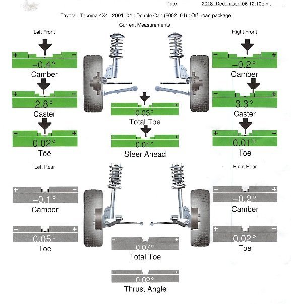

    I think this is my most recent one.

    This help me better clear my 285/75/16 on my OME 2-2.5” lift. Still had to do the pinch weld cut.
    I also have SPC UCA if that matters.

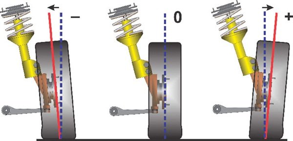

    It's your call if you want to get any further adjustments, but positive camber on any vehicle is not a very desirable thing. Sorry I was looking at your total toe in the rear and mistook it for thrust angle. You are below .10* so you are okay but your left rear side may show some mild feathering wear due to toe in over time.
    Your tires in the front are basically angled like this \ / when they should be angled like this / \ or for maximum tire life like this | | (this is an exaggerated example)
    Negative cambering provides you with better turning capabilities and most manufacturers set their vehicles up that way from the factory to assist in such. If you look at autocross vehicles they usually run their wheels very butterflied out (another term for negative camber) because it allows them to turn their vehicle basically on rails on the track. Negative camber basically increases mechanical grip via the the hubs angular position which ultimately increases the tires grip due to its mounted angle on the hub.
    Here is a visual guide to help describe what I am attempting to explain.

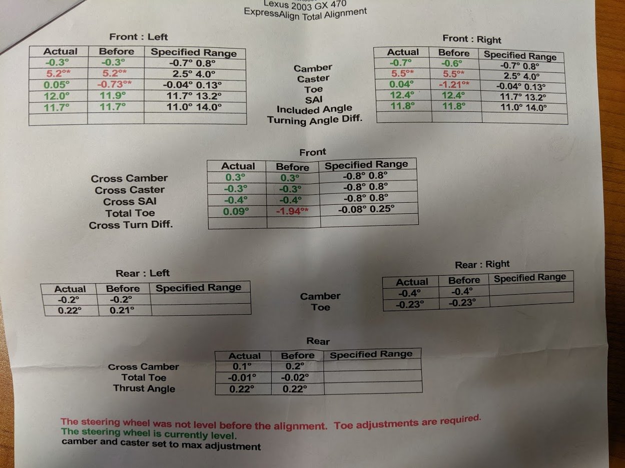

    here is an example of how much the upper control arms help on my GX (Same front suspension as a 2nd gen tacoma)
    first pic is a toyota alignment, after installing the 2.5" lift on stock arms, before shows with stock settings, and after is where Toyota adjusted it to max out caster.
    You can see they were able to significantly increase caster to almost the bottom of the acceptable range for a GX, and camber is still reasonable but went slightly positive which is not perfect but still acceptable.

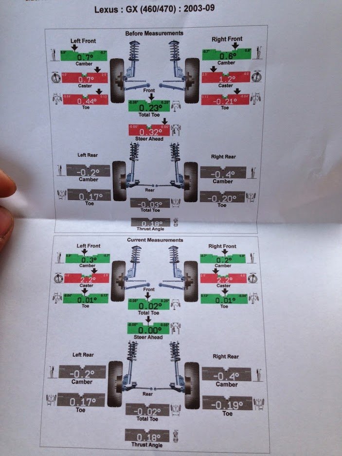

    This pic is an aftermarket shop after installing JBA upper control arms. With the extra caster, the camber is back to slightly negative and just how I wanted it.
    Notice the notes at the bottom. Ask for Caster max positive, then camber max negative in range.
