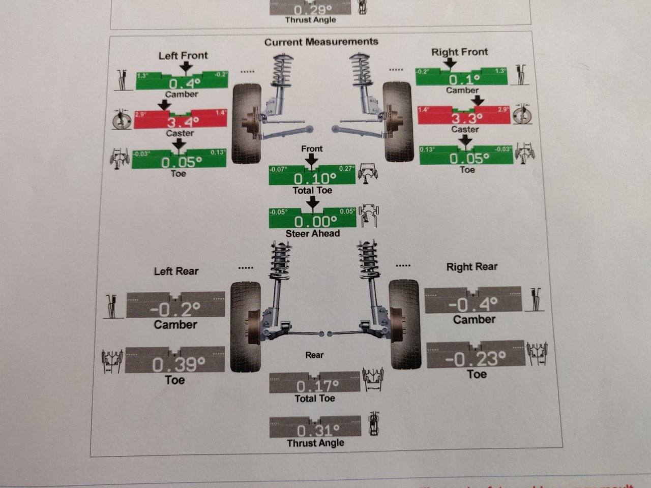

    Oh I'd be more than happy to talk to someone to set them straight. The problem is that in this industry, you can't fix stupid. Either people are willing to learn or just spout off ignorance like these guys are. If they are letting people go without at least advising them that the caster is the equal to a computer chair where the wheels are following instead of leading and it is all dangerous as hell to drive, then that shop should not be in business or needs new management and proper training for the techs.
    Automotive is ever changing, but alignment geometry is pretty cut and dry and has just about never changed.
    I actually had to do redo my steering column tack weld mod believe it or not. The stupid thing broke at the 2 fat tacks we put on it somehow even though heat penetration was plenty.
    What I'm thinking is that since I have polyurethane bushings on my steering rack which allows nearly no slop, the tack weld mod which eliminates the bushing, delrin/ poly bushings on the control arms and uniballs for my control arms is that it is just too much stress on those tacks while turning the wheel at a stop and eventually they just became fatigued and broke.

    Yep, totally agree. Crazy to me that they could tell me that with a straight face. "I've been an alignment tech for years, trust me I know what I'm talking about".... Right, buddy. I talked to the dealership, they seemed pretty cool about giving it a shot but they can't get to me until the 3rd and their alignment is only $80 but they said this might cost more and I don't want to pay dealership hourly rates unless I have to... Also talked to an old dude up the road who can do it sooner. He's not a lifted truck guy but he def got what I was talking about and said he'd try his best to get it to what I'm looking for, thinking I might try my luck with him I have a suspicion the dealership is just going to set it to factory 1.7 +- .75 and tell me that's all they could get. If I make it up there though (45 min drive) I'll talk to the guy that actually does the alignments and see what he says.

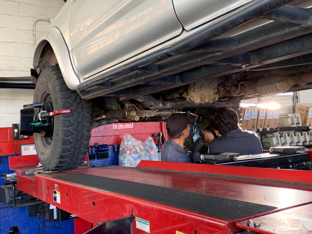

    Yep. Keep the speeds low. It's too difficult to eyeball alignments and toe changes drastically after moving camber caster measurements everytime, so I can't even say to adjust them yourself.

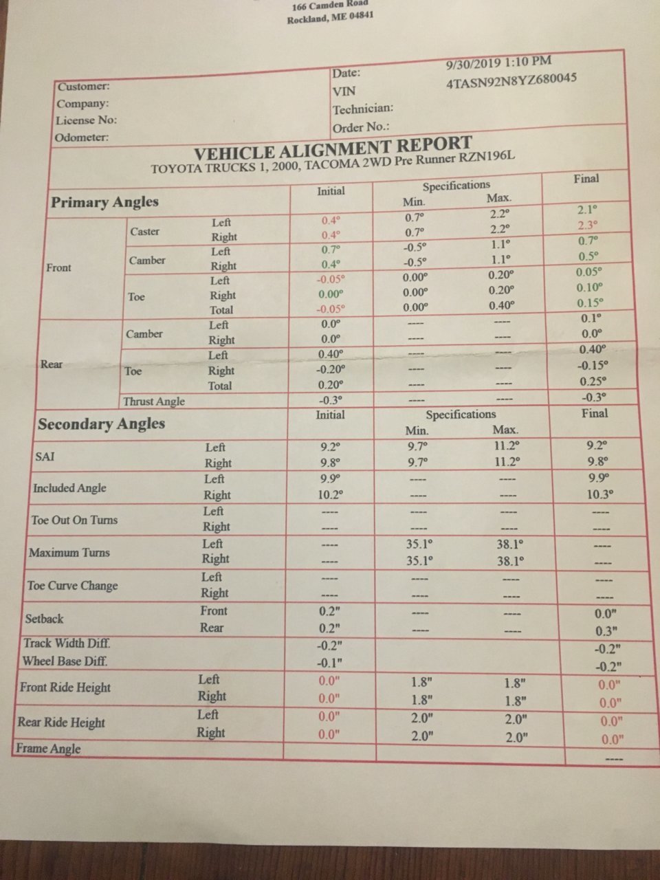

    Found a much better shop. $60 alignment too, just a little chain store that seemed pretty good. This seems pretty good, yeah? It would be nice if the camber was a little lower maybe but I didn't want them to muck around too much and lose the caster. Just happy to have it done.

    Looks alot better, camber isn't perfect but I would call that good enough.
