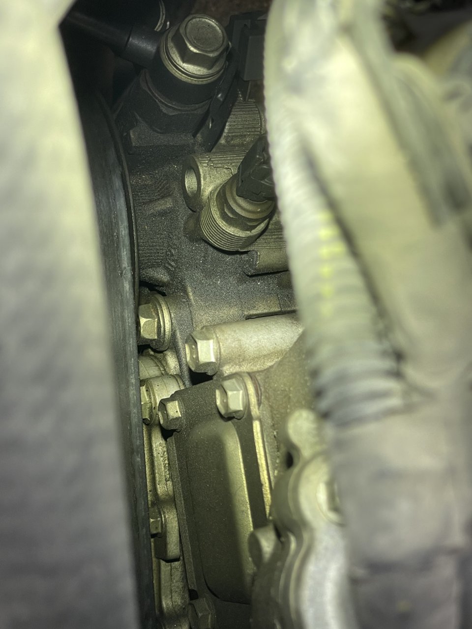

    So I’ve got a 2013 Tacoma 4.0 with 216,000 miles. When I bought it 5k miles ago the bottom was completely dry but now at my oil change the oil pan is a little wet. Upon further investigation the bottom of the power steering pump is wet too and it looks like its coming from the crankshaft seal but im not sure. The corner where the timing cover meets the valve cover on the passenger side is slightly seeping but I don’t think it could be that. The area around the crank is the most wet but if it was just the crank seal why would the power steering pump be wet. I tried to see if the fluid on the ps pump is steering fluid or oil but it’s pretty dirty so it just looked black on the towel. Anyone with more experience care to give some input? Thank you

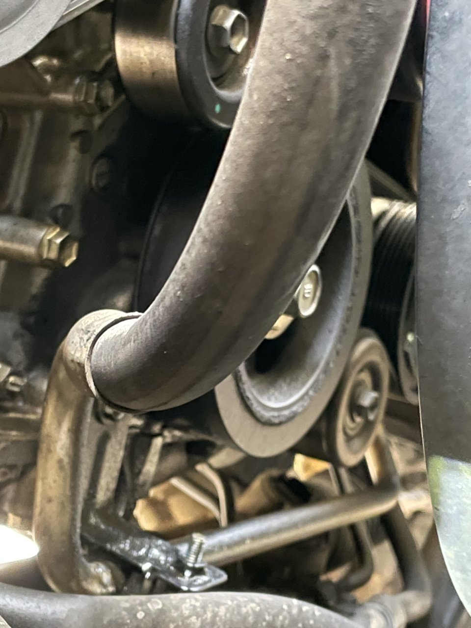

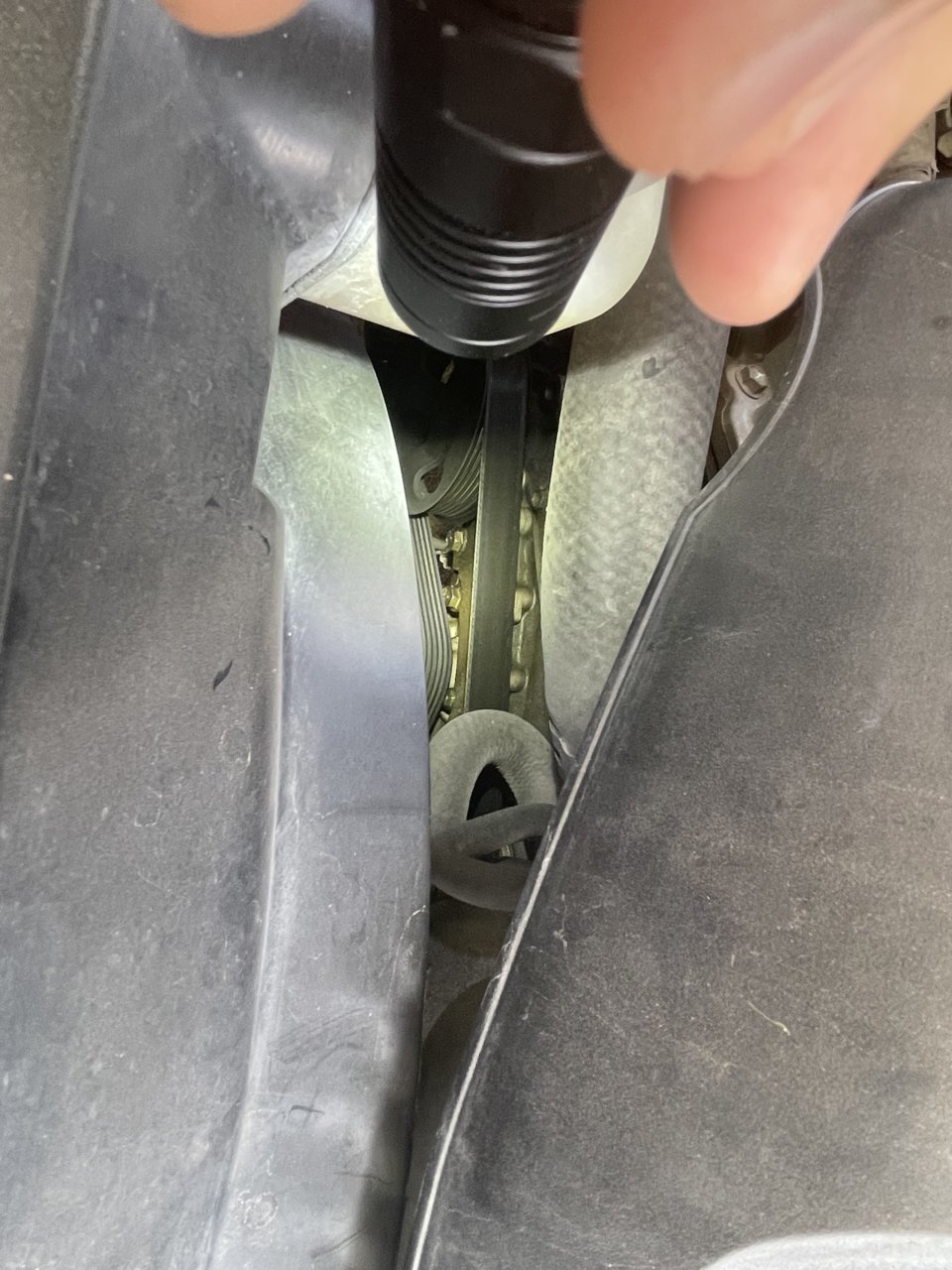

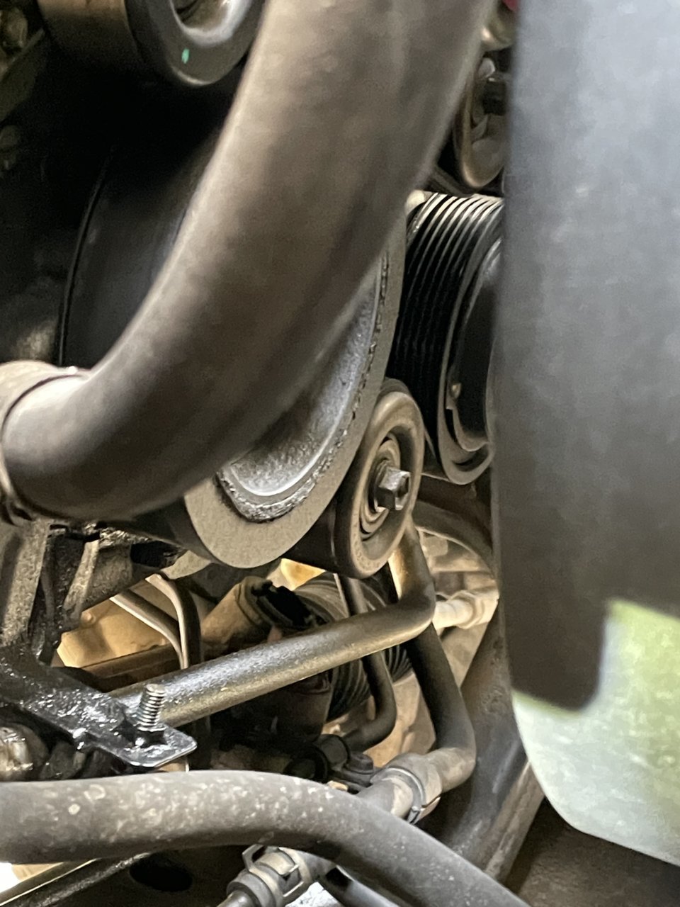

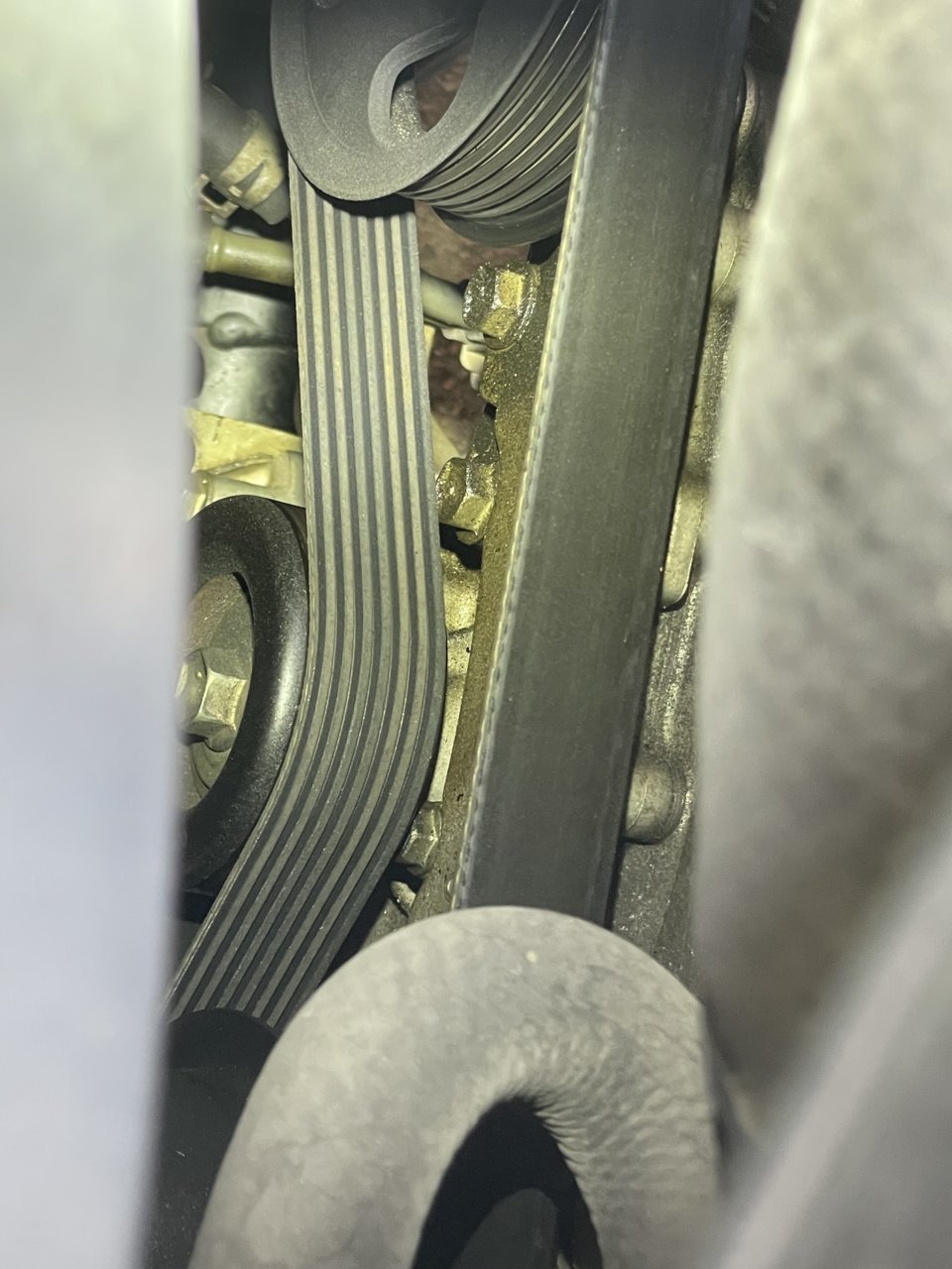

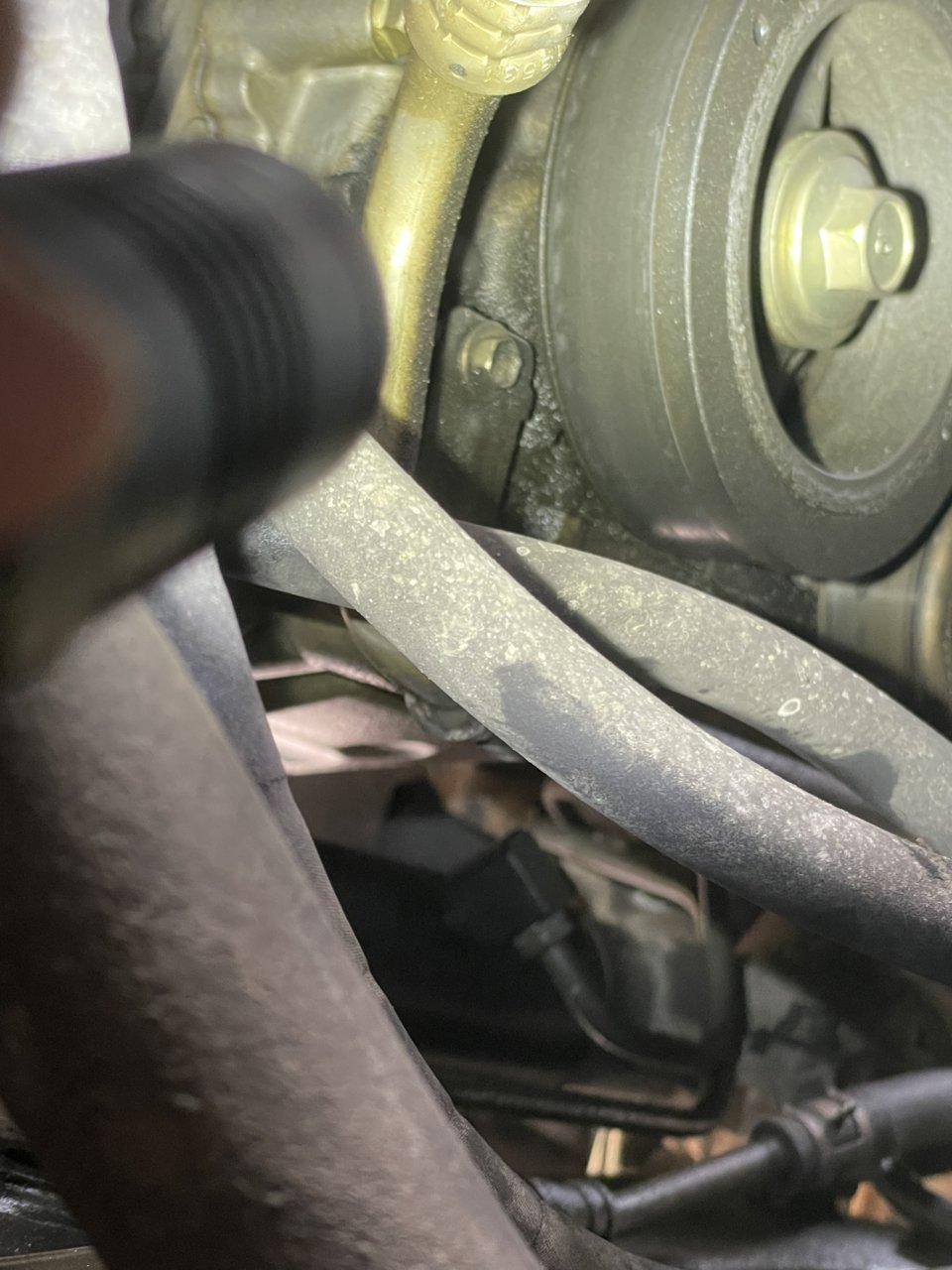

    I tried to get some good pics but man, there is way less space in there than my previous 3.4 Tacoma or my silverado.

    Look between the power steering pump and the timing cover and see if it is leaking there. If not maybe the valve cover. If you can't tell get a UV dye that can be mixed in engine oil and see where it is leaking from with a UV light.
