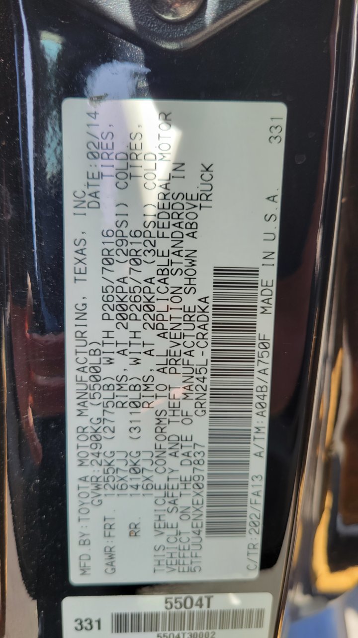

    Maybe this label is correct? But the door table says LT265 75 R16

    I ran a P rated set for my daily driving for several years when I commuted a bunch, never had an issue.

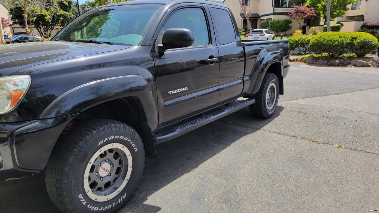

    If the wheels are original to the truck, you might have a TX|Baja or TX|Pro trim, which had the BFG A/Ts installed at port.

    It came from the factory with P rated tires. Someone added the wheels and tires

    It's a TRD Baja, they came with those wheels and tires.
    Bingo.
    https://www.autoblog.com/2012/04/25...ZTVX-OcwXHCVxkIaERRo13sHCTQ5eQTRMErbXqXhSWiz6
    @TacomawithArima
    Your base truck was a TRD Off-Road which Toyota changed out the front suspension, wheels and tires. If you use Tire Rack's calculator with a 2014 TRD Off-Road, these are the Michelins you get.

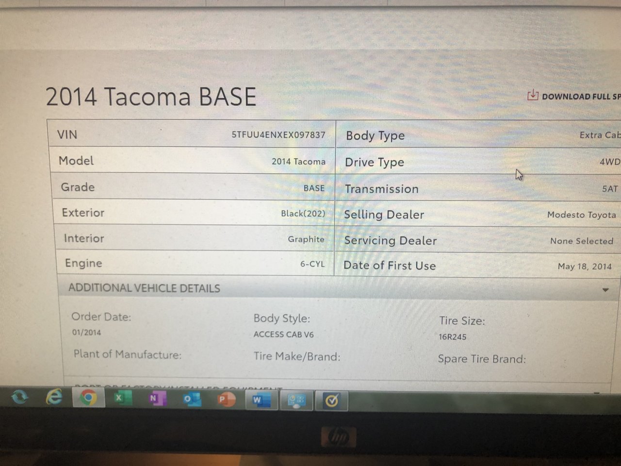

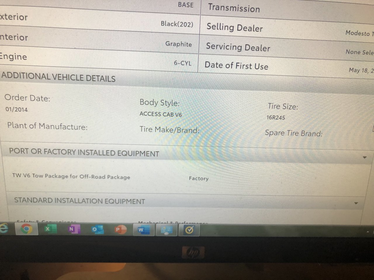

    Look your vin #up in Toyotas owner site it will tell you what your truck came with firm the factory and also what was added at the port

    I looked it up for you. It’s not a Baja. It came with p rates tires. Only factory or port option is v6 tow package for off-road package.

    Snap a photo of your front suspension. The red coils are what makes me think it’s a Baja. Did you lift your truck? Does it have the TRD exhaust on it?

    VIN won’t show it’s a Baja through Toyota’s site. I just found a Baja for sale and ran it and it pings the same as a regular TRD Off-Road.
    Those wheels on a KO in that size with red front coils scream Baja to me.
    By the time Toyota released the VIN lock on the grey beadlocks the KO2 was more common.
