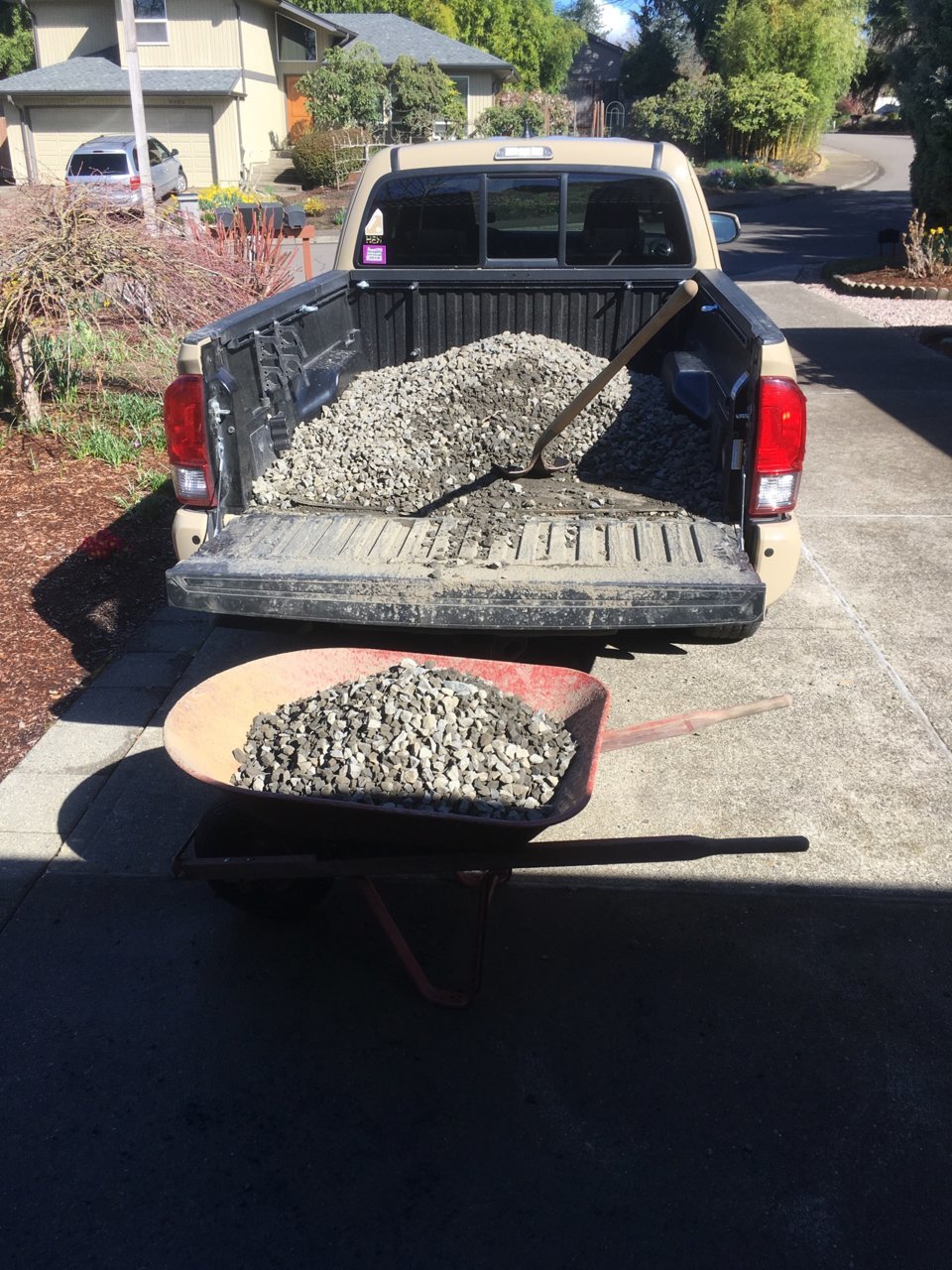

    I went with these. They are adjustable and work for me.

    How well do they work

    Very happy with them, I’ve hauled some heavy loads and didn’t drag the tail feathers!
