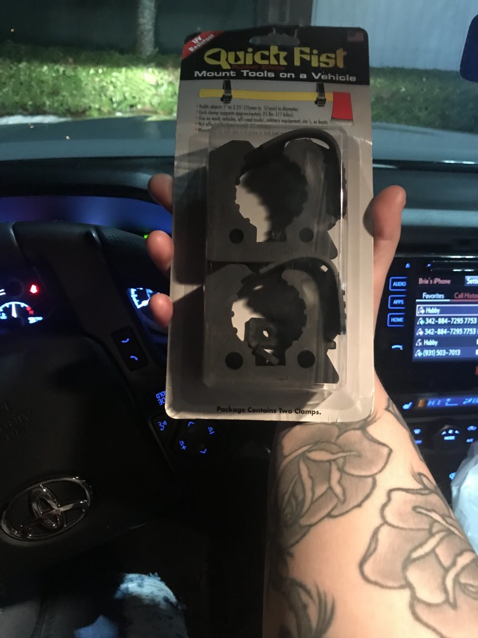

    Picked up a quick fist tool mount for a snow shovel in my bed. Do I just drill it in? Or what the hell?!

    What about t nuts into the bed rail?

    Yes the bed is just composite. Just be careful on going to far and hitting a wire harness, brake lines or filler neck on the gas tank or the tank itself.

    I don’t think that’ll work. I have the hard folding top and it’ll be too close for the shovel the latch and the top to close.

    They also make brackets that hang from the bed rail you can mount them to. They hang down to about the top of the wheel well.

    You could probably just drill them in for a flashlight or something small but the shovel head will probably interfere with the quickfist receiving the handle. Some companies make bed rail mounts specifically for quikfist. Relentless for one. Also theres some threads on here for DIY options.

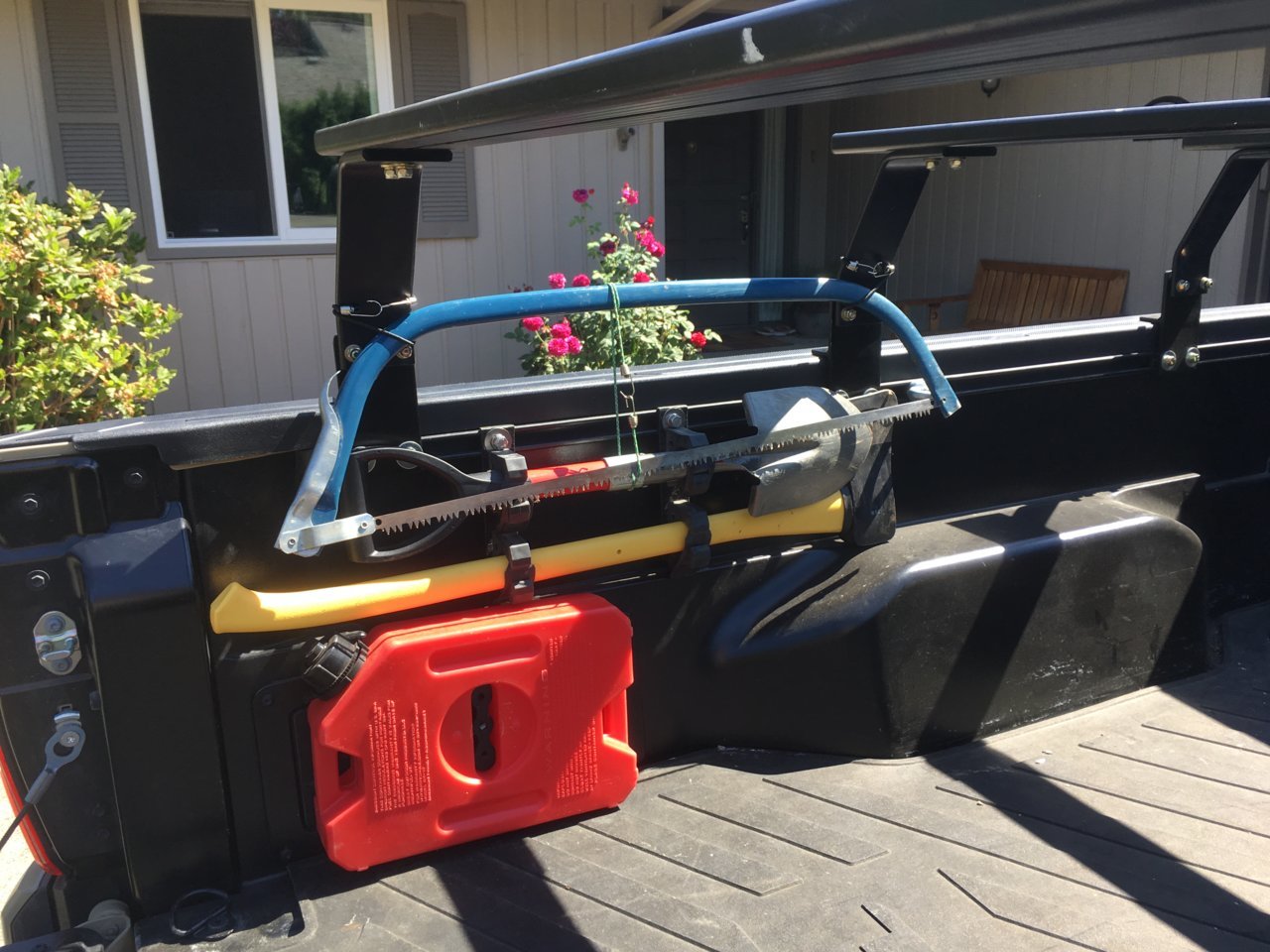

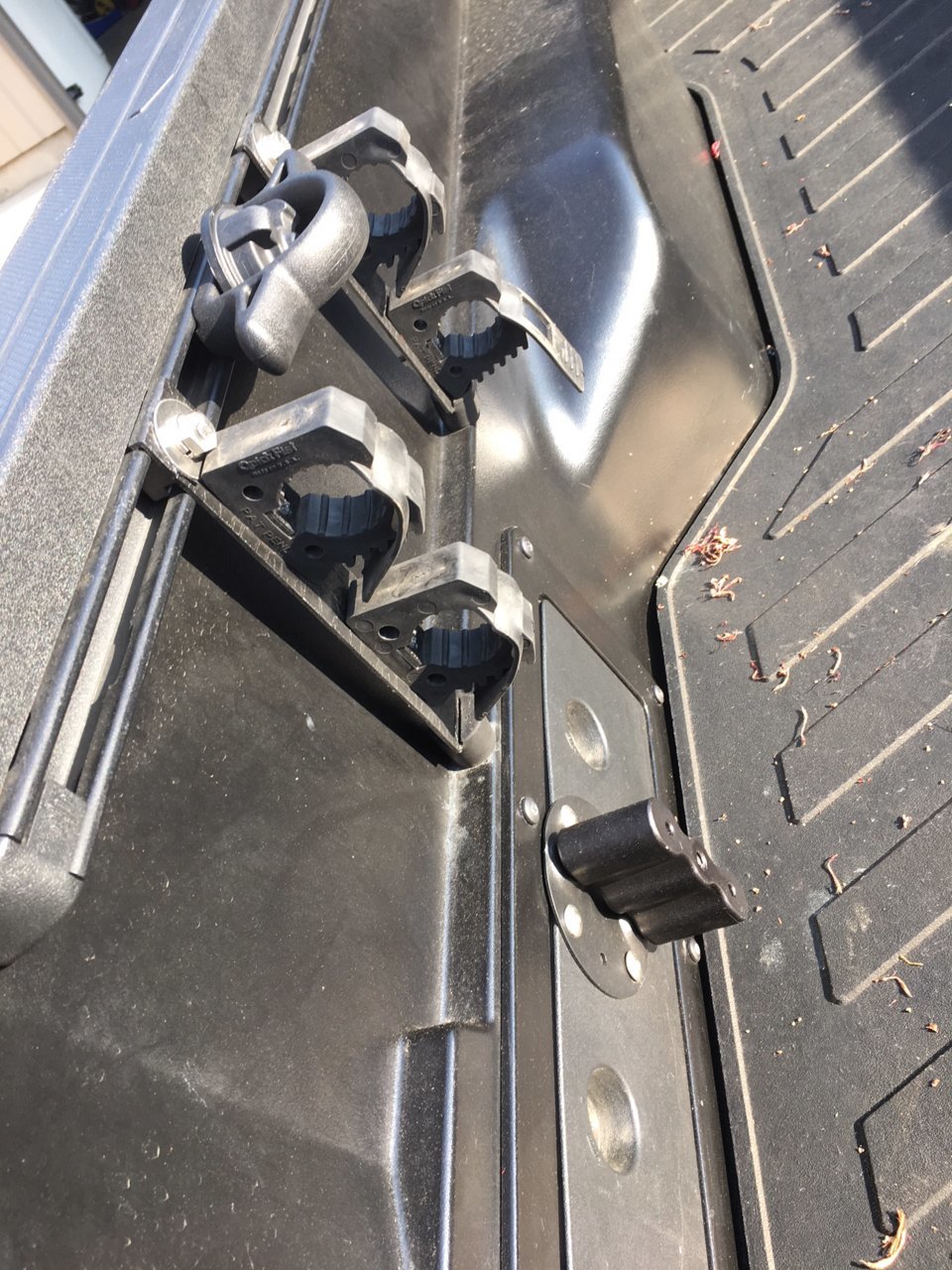

    9535868A-6D0B-4EE4-AE52-130ED95D2524.jpg EA3FC042-DC8C-4DCC-BAD3-FFF644E49F37.jpg
    Steel strap and a rubber bottle stopper.
