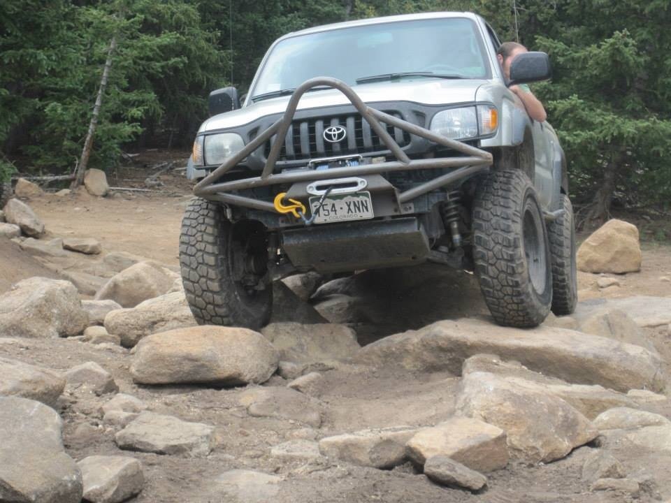

    It's less Tacoma and more mod
    It's one of those Stance Nation guy's wet dreams, just picture it on a Civic with broken camber adjustments.

    Idk, got it off Google.
