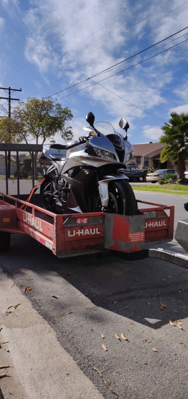

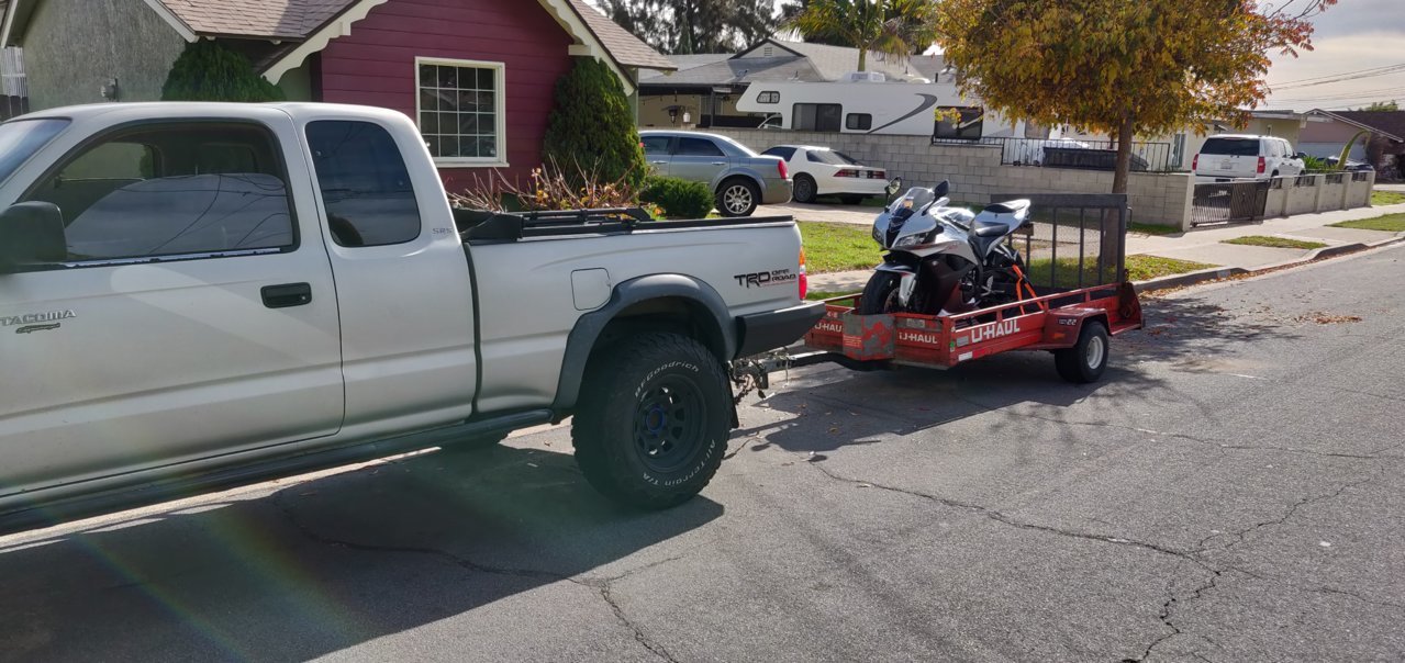

    OP, the uhaul for reference from when picking up my... Baby (cagers just won't get it):
    Looking for the pic of the handle bar specific front straps- cycle gear usually has them in stock- neat way to not tangle, strap burn etc the front end when strapping down.
