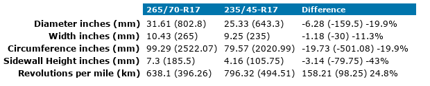

    That's a -19% difference in size. You're going from a 31" to a 25" tire. You'll lose 3.14" sidewall height (that means losing 3" of ground clearance as well).
    So at 50mph on your speedo you'll be doing 40mph;

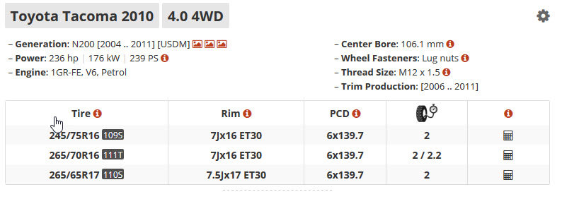

    That's if a Tire shop will even mount a 235 on an oem 7" or maybe 7.5" wheel.
    I mean, I like stretch as much as the next 'dubber, I just don't think it's a good idea.

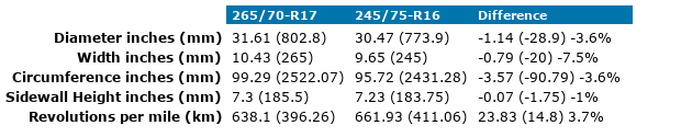

    btw - smallest stock tire on a 2nd gen was 245/75R16. That's around -3.6% difference

    265/70/17 tires are 31.6" tall and 10.5" wide
    235/45/17 tires are 25.3" tall and 9.25" wide.
    So the snow tires will make the truck have 3" less ground clearance.
    And the 45 sidewall will make it ride a bit rougher.
    Snow tires are typically narrower anyway - to put more pressure onto a smaller road contact area.
    I wouldn't hesitate to do it and I cannot imagine how it could be unsafe in any way.
    Isn't the stock tire size for your truck only one size larger (245 vs 235) ? Both a 235 and a 265 are good for a 7-8" wheel width.
