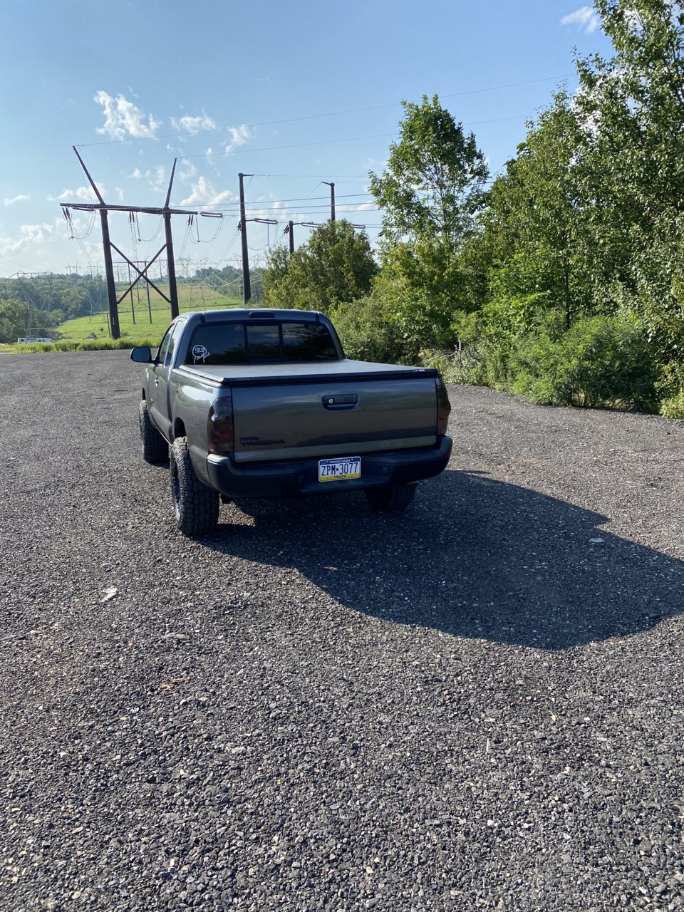

    I gotta 2014 access cab and was wondering if I would be able to stuff some 33’s on. I’m running 31s right now and had to take out the black box but I really don’t want to have to chop more.

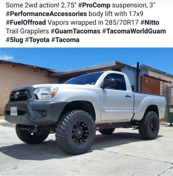

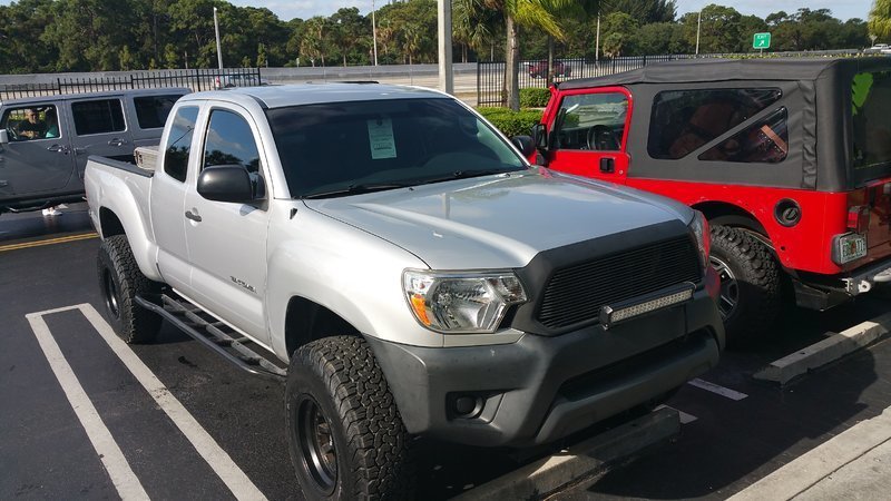

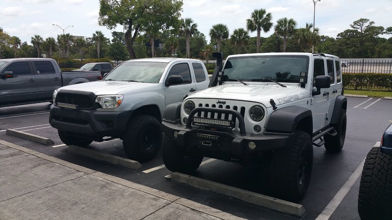

    Is that a 5lugger? 33’s I’m sure can be done, not sure if your truck is lifted or not. Suspension lift, body lift and lots of cutting/trimming…if you don’t plan on off roading lol.

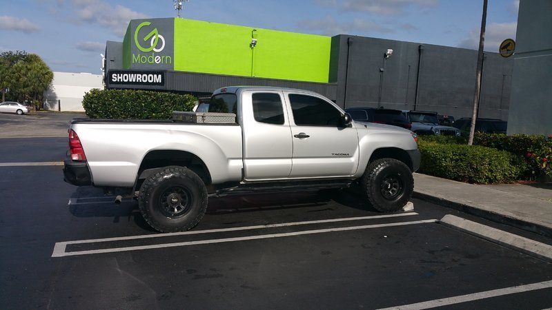

    Ive got 33s on my access cab without rubbing. On SAW coilovers at about a 2.5" lift, jba UCAs, sway bar relocate, and wheel spacers. Only time Ive had rubbing issues is when Im fully flexed out or landing after jumping it. Only had to do very minimal trimming on the fender flare
