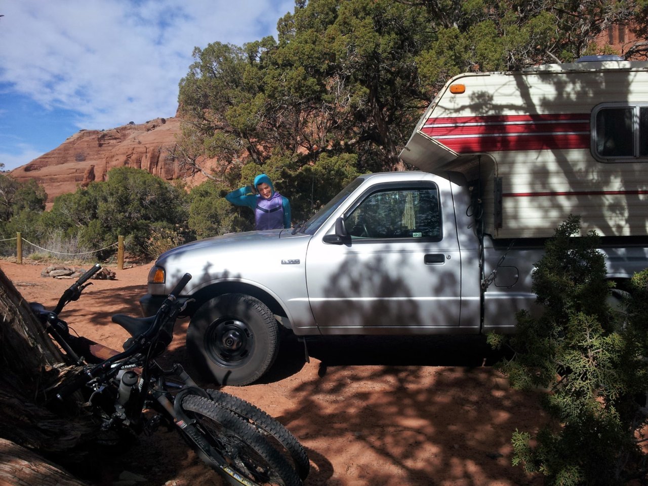

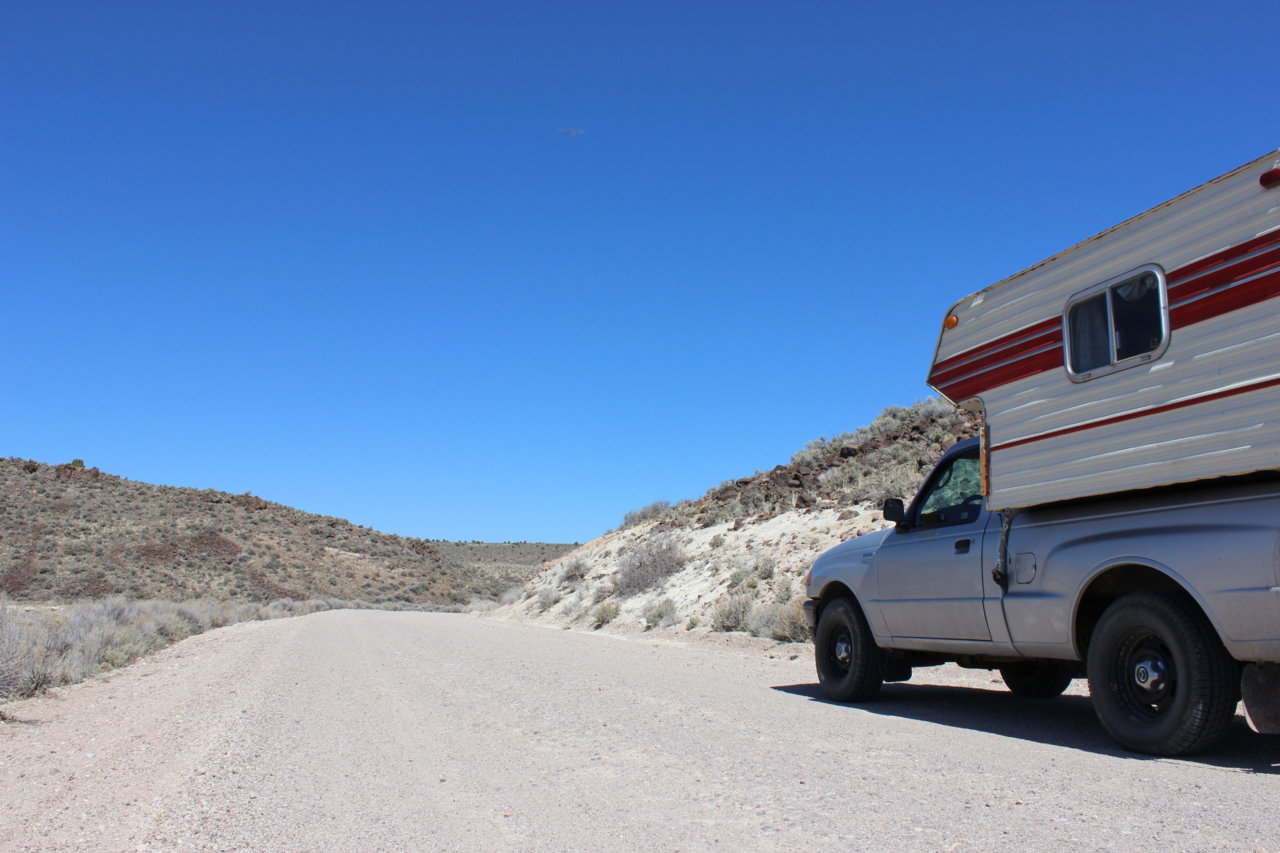

    I used a cab over a bit on the Tacoma, but for about a decade on my Mazda b2300 ( 4 cylinder 2wd reg cab Ford Ranger). Note that in my case, the cab over portion was used for storage, and the bed was the kitchen area that went east west. It absolutely can be done if you get a LIGHT WEIGHT set up, get your truck set up properly, and drive accordingly. I put about 20,000 kms on with my camper, but you have to be set up properly to not endanger yourself or others. The key is getting solid frame mounted tie downs ( I custom fabricated mine and mounted them to the frame rails with grade 8 1/2" bolts. )
    The next step is air bag suspension or Add A Leaf leaf spring helper. I always went with the former. This is non negotiable, as you will have a dangerously light front end without the rear being helped out.
    For everyone saying get a trailer, that just doesn't work in some scenarios; certain terrain, or trying to park your rig in a city are not possible. Maybe you want to tow a boat...
    It's a lot of work, and it is not cheaper than a trailer, so ask yourself if this is what you really want.

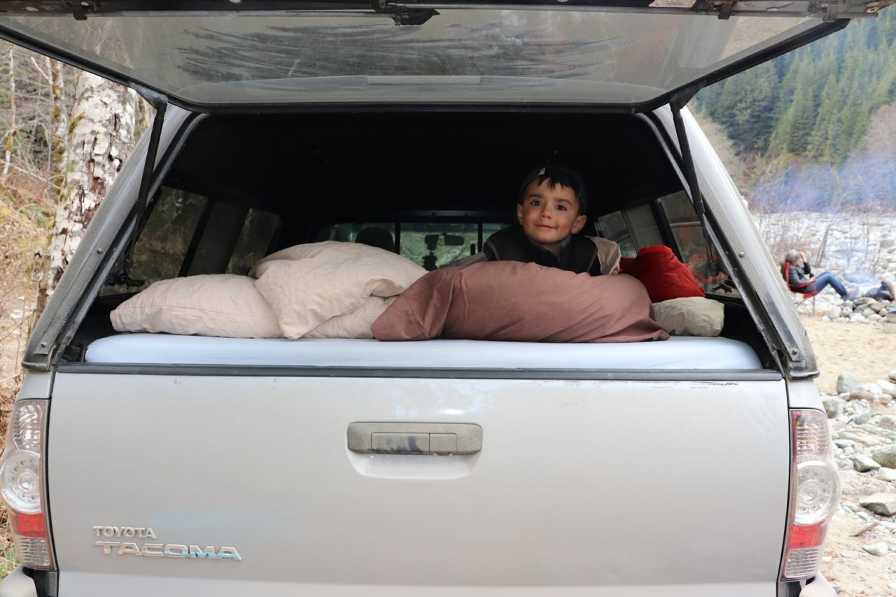

    I foolishly sold my 6'6" 700lb camper after completely redoing the interior and rebuilding any leaks shortly after getting my Tacoma. Ice box, heater and stove worked great. I have been using a camper shell with a platform for my ikea mattress ever since (shown in the last pic).
    Will this be your only home?
    I was able to live in my super small camper for multiple weeks on end, but you are going to have to deal with not having a toilet. Any unit with a shower or toilet will be way overweight.
    Here's some pics of my camper in my B2300:

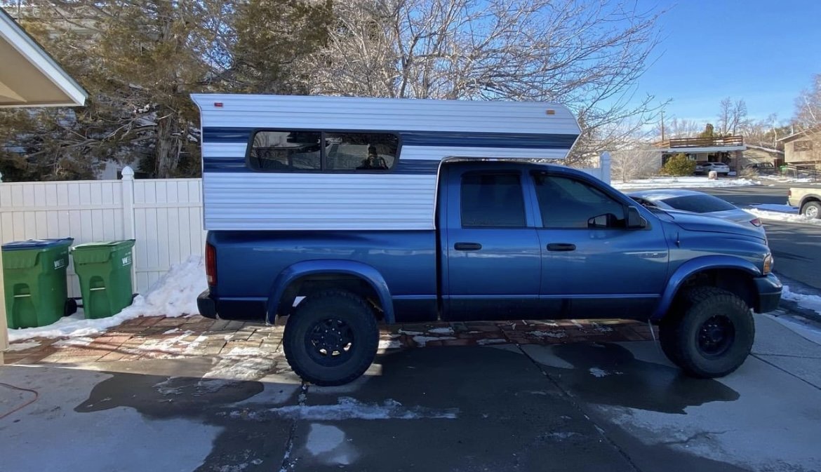

    SOS bolt-on sliders In-cab sleeping platform J-Dub IFS Skid
    Can you? Sure
    (This one was running a trailer and hammer down on whoops, so, kinda did it to himself for sure)
    For sure, some of these are stupidly overloaded. But remember your truck is rated for payload - that includes EVERYTHING that's not from the factory, including passengers.
    As an example, my truck is a 2020 Off Road DCSB. Payload is (about) 1400 lbs (I've seen some other number, but, hey whatever). I can fit 4 people, let's say average Americans, 200 lbs a piece. My payload for crap in the bed is now 600lbs. Roof rack, side steps, I'm down to 500lbs USABLE payload with 4 people. That's not a lot :)
    Looks like a 99 prerunner is a 2k ish payload, with less passenger capability for sure. But even still, just be aware of what your payload is - not because at 1lb over it'll snap, but that's what Toyota said the frame can handle, and if you go way over that...well, see above series of pictures of others who thought "Eh, it'll be fine"
    cmonjack and RugglesTarlek like this.
