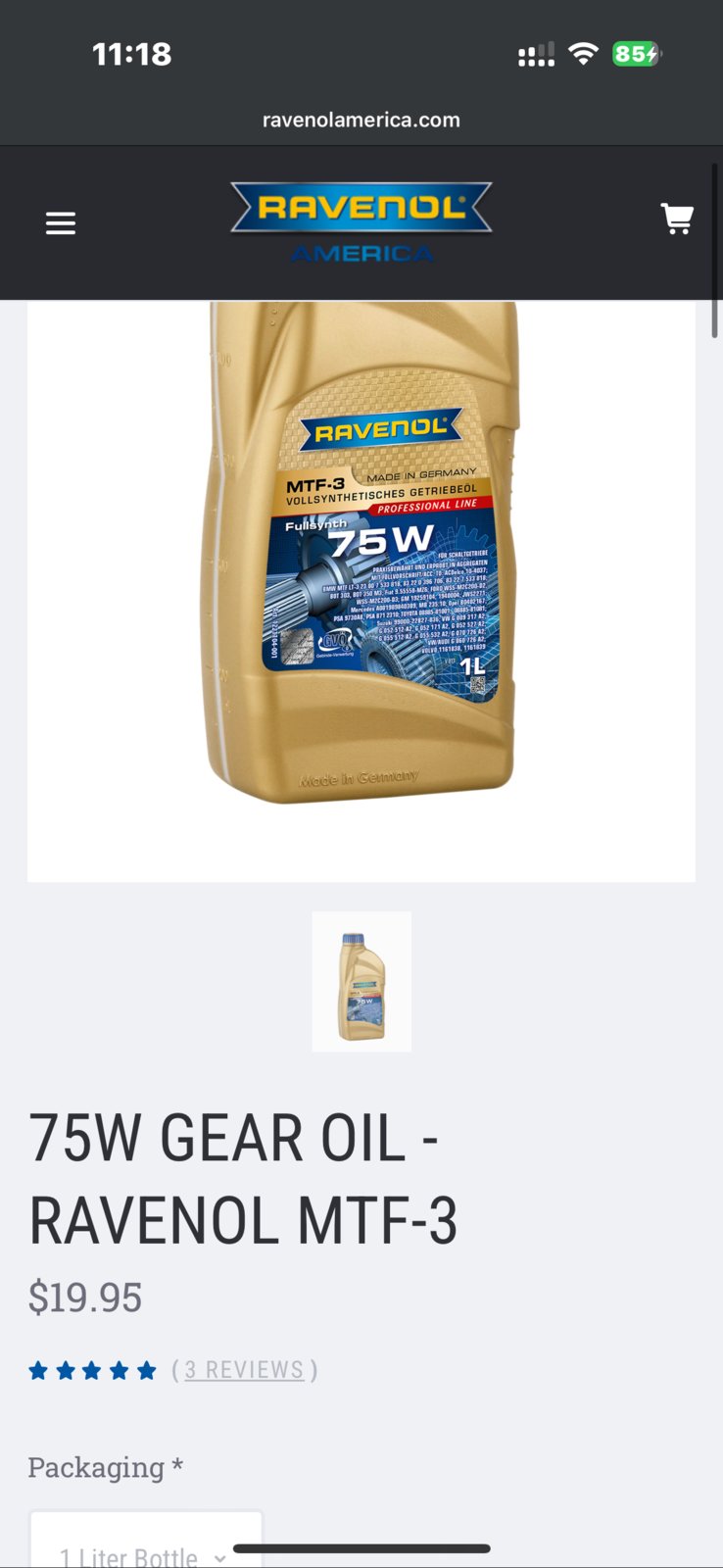

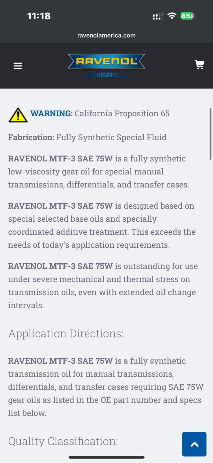

    I live in the Middle East so I need to ship this stuff here. Usually I put 80w-90 or 75w-85 or 75w-90 in my TC but I read someone that it’s bad for the TC so I’m gonna order this stuff.
    but in the description it says it’s for manual transmissions. Mine is an automatic. Is that fine? Thanks.

    Yes, perfect for the transfer case

    It says it’s for the transfer case …not just manual transmissions .. so answer is yes .

    Yes! That's the stuff for the transfer case and no pump needed thanks to that brilliant bottle!

    GL5 does have sulfur in it since it's meant for extreme pressure situations like differentials. For that reason I do use a GL4 manual transmission oil in mine. However, GL5 was officially approved for the transfer case in the 2nd gen, despite the sulphur. Most GL5s have an inactive sulfur, which starts to act at higher temps than a t-case should reach. In short, it should be perfectly fine. 2nd gen and 3rd gen transfer cases are very similar, and a synchro is a synchro. They wouldn't have spec'd it.
    I like 75W-90 or 80W-90 over the stock 75W because the transfer case shifts more smoothly with it. 75W is fine and it will work, but it's an economy choice.

    There's a reason they spec this specific oil. Some people claim it's the brass. It's not an economic choice - this is a differently formulated gear oil and is actually more expensive. Use what they say to use. And yes, the bottle has a cool spout.

    I put the Ravenol 75W in mine a few months back. The shipping cost more than the oil if I remember right. Maybe there are some other tacoma owners over there with you. Maybe have a case of the stuff shipped? I tried but could not buy the oil on Amazon or Walmart.
