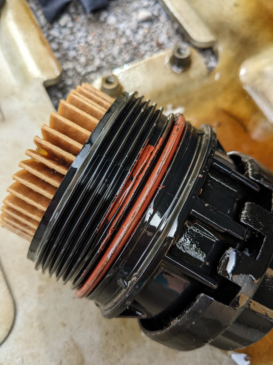

    It looks like the oring was pinched. I saw a small gap in it when I was unscrewing it. Once it was completely off, it snapped back into position.

    ^Is that a Toyota filter purchased through a dealer? The O-ring appears to have a pronounced mold line on the sealing surface, more prominent than the Toyota filter O-rings in my garage. Is the red stuff a lubricant you added?

    Was it cross threaded? The orange (is that damage?) is not where the threading starts...

    Please tell us that orange stuff is NOT Form-a-gasket or RTV sealant!!!!
