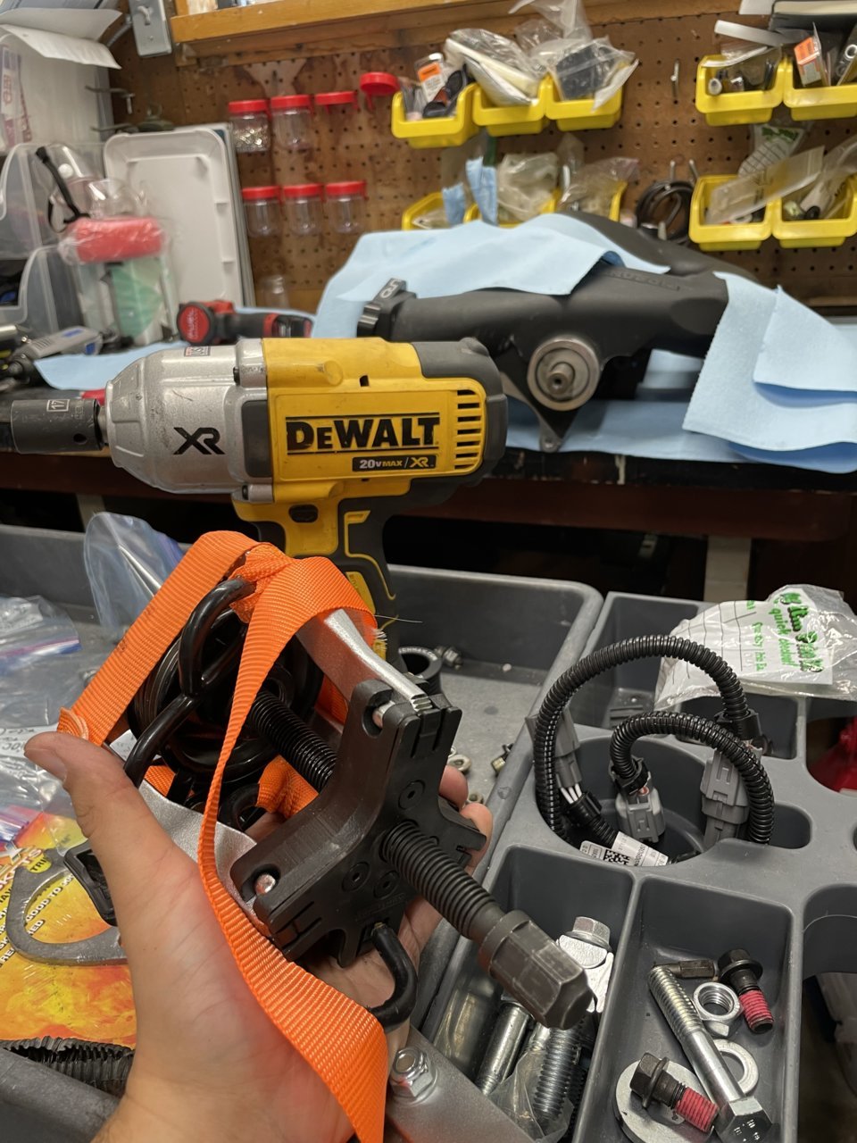

    Use power tool at your own risk but this was my set up. I strapped the craftman 5 ton puller with the stealth URD sc pulley. The stock sc pulley didn’t need the strap.

    For removal you can, I did. Just be careful.
    I also used impact driver for trimming the snout.
    When installing the new sc pulley, elbow grease.

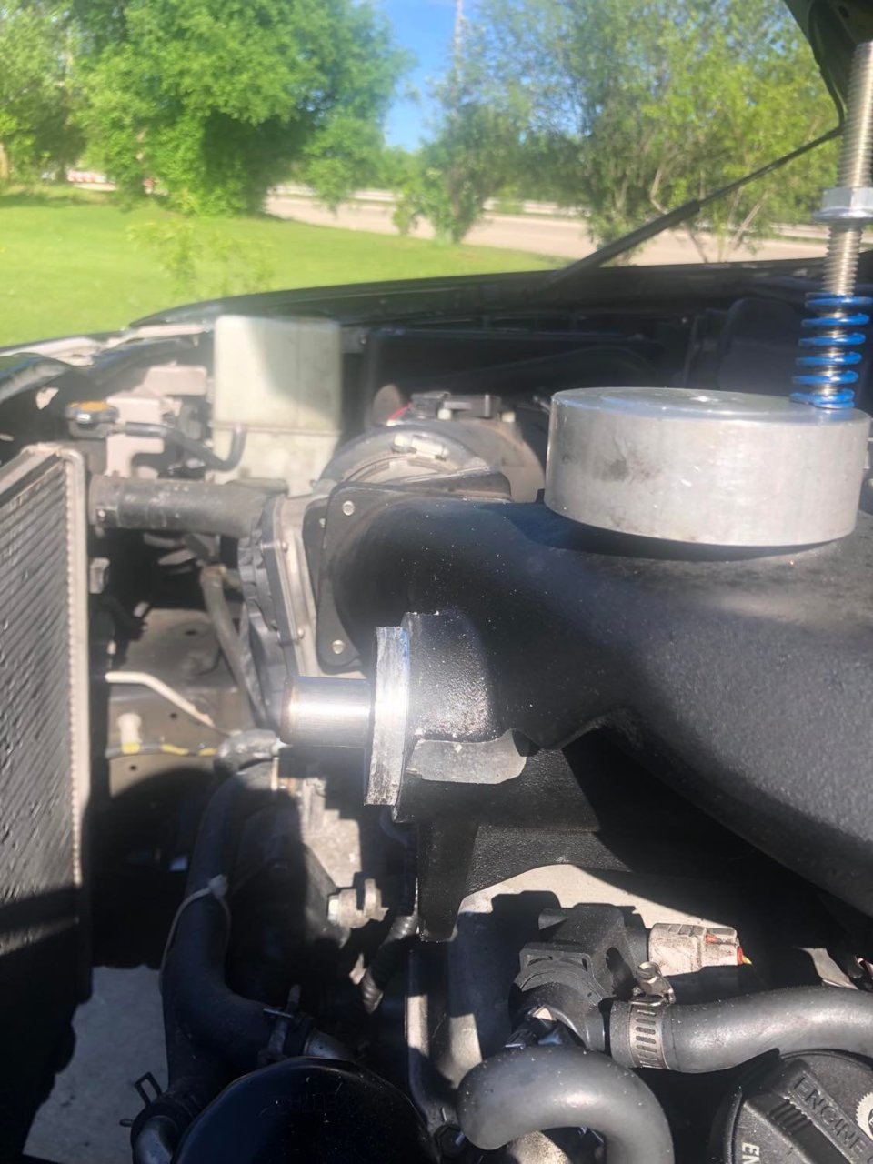

    Got the snout cut.

    eeeek. I did not use an impact. I would also be very careful with impact trimming. I was not as lucky and broke the bolt not once but twice. That was a bitch to remove. It works easily with a regular socket but just takes a bit longer. A few extra minutes for peace of mind.

    Nice, if it warrants you can prob go a bit farther but depends what pully size your going to go with later on. my 2.8 fits but not sure my 2.5 will fit with how far I cut. (around the same)
