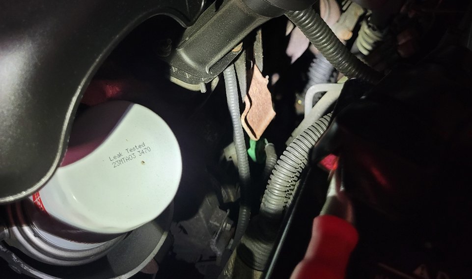

can i remove this bracket?
Discussion in '2nd Gen. Tacomas (2005-2015)' started by hinmo24t, May 7, 2025 at 4:57 AM.
  1. May 7, 2025 at 4:57 AM
    hinmo24t
    hinmo24t [OP] MAhole
    Aug 17, 2018
    #263138
    421
    tom
    dartmouth, ma
    2015 TRD OR , blue ribbon metallic
    its like one of the only rust spots in my engine bay and appears to attach nothing??
    it is coming off another metal support of some sort, up the drivers side of engine

    Just shot some fluid film on that one yesterday when I changed my oil, rust is just starting
    I assumed it did something, didn’t check, lol. In for answers about what it is

    I think the only purpose of that piece of metal is to protect the positive terminal on the alternator from things touching it. Since that post should be hot at all times, its connected to the battery.
    a400ryan and hinmo24t[OP] like this.

    Haha yes that piece is weird. Believe it or not its purpose was to apparently prevent water from dripping on the alternator field connector
    Strange but true
    a400ryan, lowmower and hinmo24t[OP] like this.

    THANKS TO YOU AND taco sauce i dont think ill be removing it hahah because if thats the intent it works and is rusted-doing its job perhaps lol
    i guess ill try to get some oil on it instead

    Cice, makes total sense now. always seemed ussless

    Dang. I was close

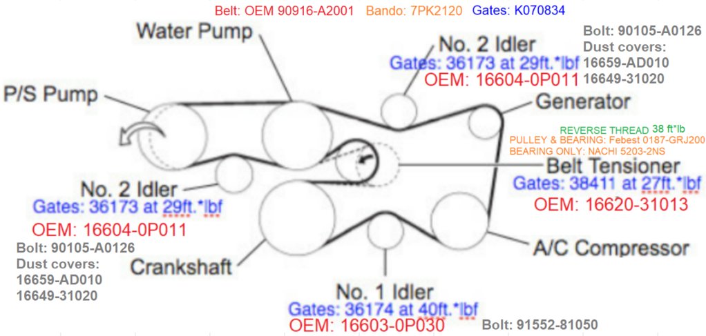

    Interesting to learn that about that bracket haha. Figured I would mention the rust on the pulleys is probably on the thin metal cover plate/dust shield not the pulley or bearing itself. Just get new ones when you decide to replace them, its a super easy DIY aside from if you do the whole tensioner assembly. If you can change your oil and do brakes you can do them no problem! Attaching this diagram I made/added to for reference
    hinmo24t[OP] likes this.

    thank you. i think i snipped that diagram to my tacoma diary word doc. thanks for the confidence and i was real glad to hear about those face plates!! not the actually pully
    appreciate it

    I’ve always wondered what this was !
    I thought something broke off and obviously best course of action is to pretend like I saw NOTHING :thumbsup: now I know its a badass little shield
