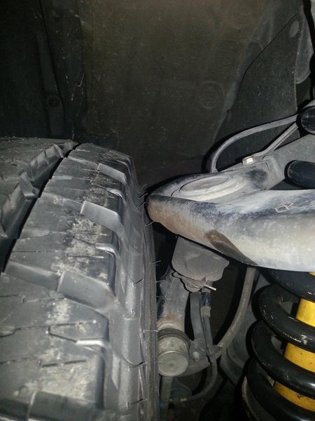

    There is no doubt that the tires will fit the rims. I am thinking if they will fit on your truck. Sometimes the tire hits the upper control arm.
    This is a newer tacoma but could happen to you
