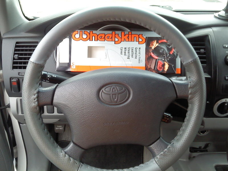

    Love it. I would not own a vehicle without a Wheelskins cover unless it came with leather from the factory.
    Order from eBay... Wheelskins has an outlet dealer that sells there for about 25% off list.

    How much more circumference does it give to the grip? I'm looking for a nice wide feel.
    And does that cover ever slip? I, like most, "palm" the steering wheel when turning sometimes... don't want the cover slipping around the wheel.

    The cover is very tight on the Tacoma wheel. On the left just above the upper spoke, you can actually see "stretch marks" that happened when I was pulling the cover over the wheel.
    It ain't going anywhere ;)
    Thickness, it doesn't add a lot, about the same as those cheap plastic/rubber wrap-on covers that they sell.
    Anything more than this for thickness and I'd recommend the above link and a full custom job.
    Takes me about 20-30 minutes to lace one of these on, but I've done about 6 of them since I first started using them back around '96.

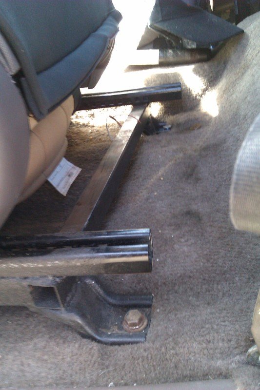

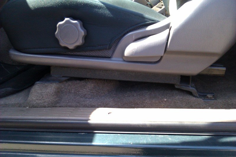

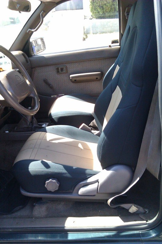

    Found some 2002 Celica seats for 85bucks a pair ,only catch was drivng 3hours round trop to get them.I stripped the rails,seats,bolts,and seatbelt wires out the Celica. To install I had to use the bench seat bolt locations ,had to weld the Celica rails to some of the bench rail(bench is dismantled/trashed in process).That way I can put these seats into any other taco like mine and I keep my truck seat mounts.To make sure the seats did not sit too low had to use 1"sq tubing.
