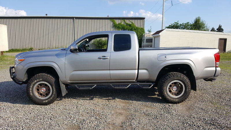

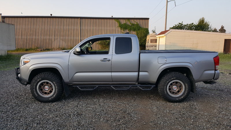

    Scott,
    Awesome build and great pic. That is pretty similar to what I want the finished product to look like. I don't however want to replace my front bumper. How much is the OME kit that you installed?
    As far as tires go, I've heard I can get away with 265's without a lift but I'd like to have the option to go bigger if I had the lift to avoid any rubbing.
    So 5100's with a leveling kit would not work in conjunction with each other? Would new UCA's and AAL's come into play with the 5100's or the OME?
    scottalot likes this.

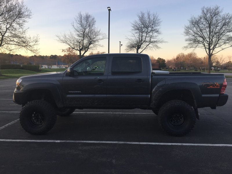

    Hey Derek,
    Here is a good comparison for ya, you can run 265 75 16s on stock suspension (this applies for all trucks on stock suspension from 05-16), I'll post a pic of my truck for a comparison!
    265 75 16 Goodyear Wrangler Duratracs on stock suspension:
    265 75 16 Goodyear Wrangler Duratracs on OME Suspension with Dakar Leafs, full 3" of lift on the front and the back:
    OdinBow likes this.

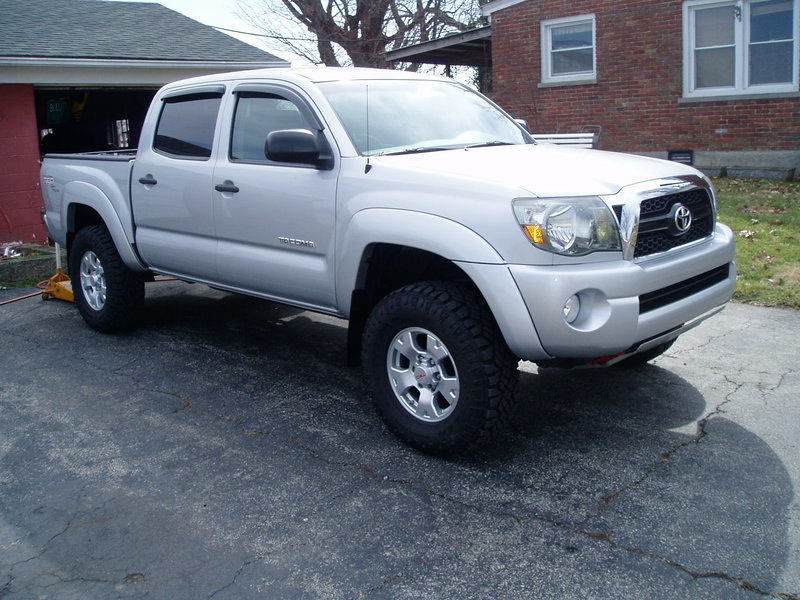

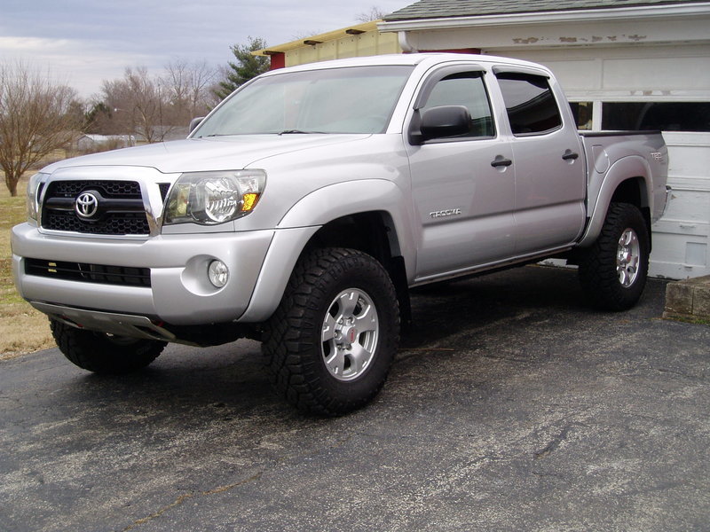

    Bilstein 5100's on all 4 corners. Fronts set @ 0". OME 885X coils. Most need a 1/4" spacer on drivers side front to sit level. For some reason, mine needed 1/2". Netted 2-5/8" lift front. Rear got a Deavers 2" AAL for a full 2" lift. The struts (shock and coil) was assembled by Headstrong, which gets you a new "top hat" as well. I also installed a Ubolt flip kit while I was at it. All that came from Headstrong Offroad. $733 for the lift and another $79 for the Ubolt kit. (which you don't HAVE to have) You can save a few bucks by assembling struts yourself.
    Tires are 265/75/16 Duratracs (load range C) They cleared with flying colors BEFORE the lift. I also put 1" Bora wheel spacers on to get a bit wider stance.
    I cannot force the tires to rub anywhere. Rides great. drives great. Alignment specs were ideal....(2.9 degree caster w/o aftermarket UCA's) I own a restored Airstream travel trailer (16') This truck pulls it quite well.

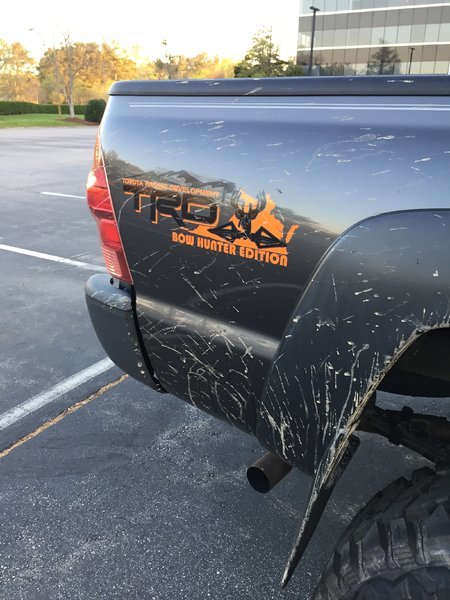

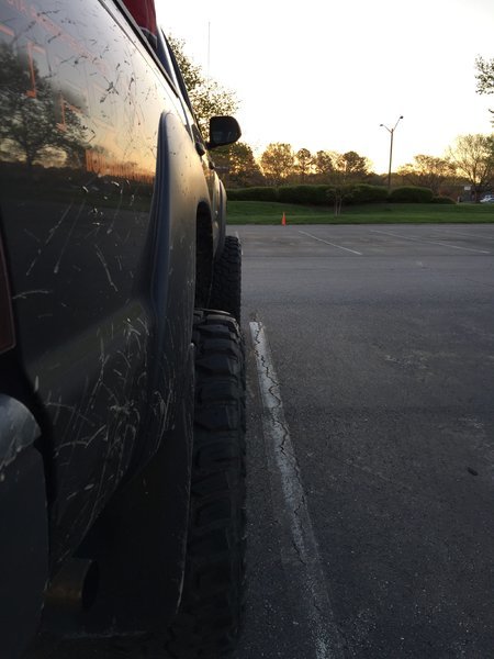

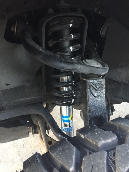

    Well gents, i finally pulled the trigger last month and i wanted to show you guys how it turned out and to say thank you for all of your help and advice!
