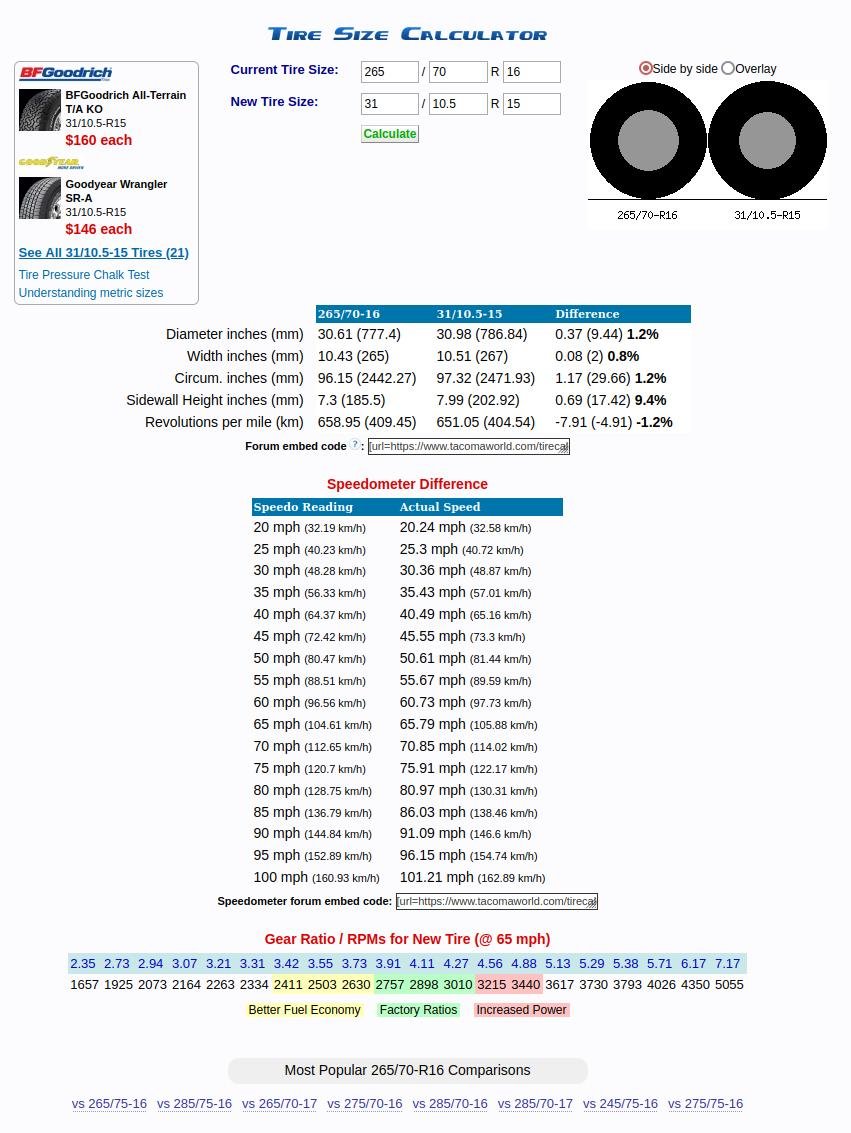

    That's a 10% increase in diameter, so your speedometer will be off by 10% also. You aren't going to damage any internal gearing, but it won't accelerate as fast as with the smaller diameter tire. You will want to put those tires on an 8 inch wide wheel though. Otherwise you'll get that silly stretched look, and if you air down you can run the chance of popping off the tire bead. Tires will clear no problem.

    265/70/16 is a stock size, which is nominally 31". I have these on my 3rz and the speedo reads high compared to roadside speed signs and gps on my phone. My next set of tires will likely be 265/75/16, which should: 1. look cooler, and 2. ring the speedo closer to reality. If you don't need load range E tires, then you can stay away from those and just stick with passenger tires, which are usually significantly lighter for a given size and tread design.

    10%?! Where are you getting that math from?
    As others have said, the 265/70r16 is the metric equivalent of a 31", and is the stock size that comes on these trucks. There is effectively no difference.
