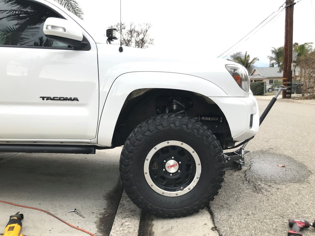

    You're not lying about the chopping! My setup 33's with 1.25" spidertrax in the front, 1" rear. Cab mount chop, 1" radius chop on flares and fenders to properly cycle suspension at full flex.

    Nice, can you post a pic of the front? Thanks.
