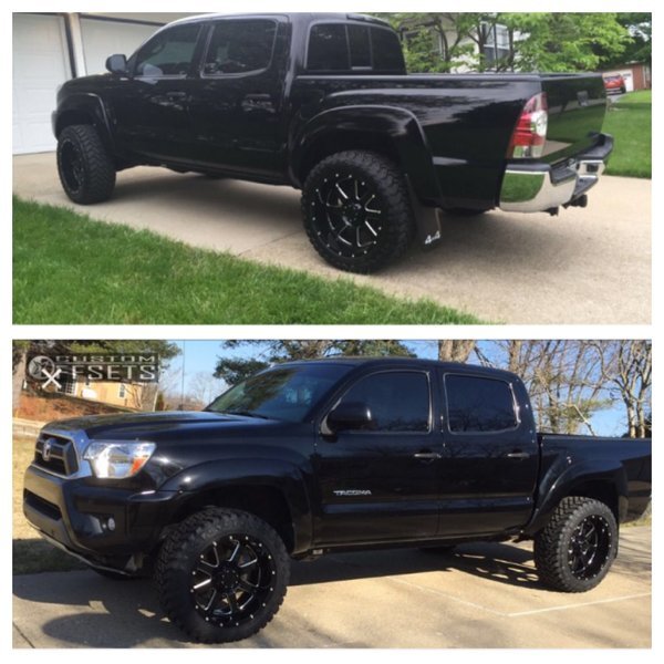

    Research my friend you'll learn a lot.
    But this guy did 32s and 20s on a 2" leveling kit

    Will need to remove mud flaps and do a cab mount chop. Make sure your wheels have enough backspace to clear, 4.5 or less.
