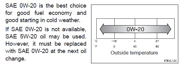

    I find it rather odd that charts shows little to no difference in the oil grades from 0w-20 to 5w-30. I can get all the 5w-30 mobil1 here cheap vs their 0w-20 so i might as well try it.
