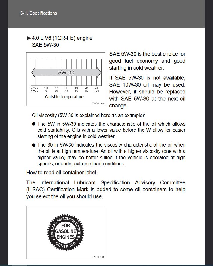

    Interestingly, the oil filler cap on my 2014 V6 shows 5w30, and the manual says 5w20 or 0w20 synthetic. I always found this curious. The filler cap appears to be stock. That said: I put in Valvoline 5w30 conventional in the summer and Valvoline 5w30 full synthetic for the fall and winter months. There's no logical reason for me in picking the brand: if Valvoline isn't there in the viscosity I want, I'd pick Castrol, Pennzoil or Mobil 1 in either flavor: Conventional or Synthetic. Castrol GTX was my go-to for years on my turbo-charged Volvos.

    Weird, my 2014 TRD OR V6 has 5W-30 on the cap & in the manual. I think you may be looking at the spec section for the 2TR on page 535
    https://assets.sia.toyota.com/publications/en/om-s/OM35A38U/pdf/OM35A38U.pdf

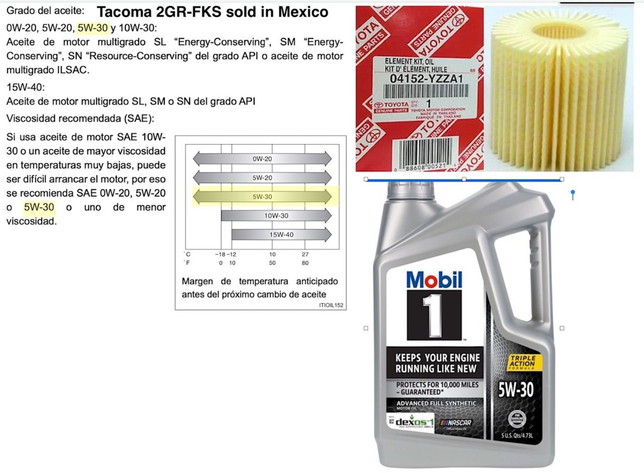

    So I dropped that text into google translate and got this. It doesn't even say 15w-40 is bad, just not good in low temps. I always thought oil viscosity was important in these tight tolarance vvti engines with oil actuated timing stuff, I guess not. If your thinking the thicker oils are just intended to be temporary I don't think thats what its saying (unless something is lost in translation), in the US manual it says "SAE 0W-20 is the best choice for good fuel economy and good starting in cold weather. If SAE 0W-20 is not available, SAE 5W-20 oil may be used. However, it must be replaced with SAE 0W-20 at the next oil change." It clearly states to swap to 0w-20 at the next change. The Mexico manual doesn't say anything like that, just the temp recommendation.
    Manual from Mexico
    "Toyota Genuine Motor Oil” has been used in your Toyota vehicle.
    original Toyota engine. Use a “Toyota Genuine Motor Oil”
    Toyota certified "Genuine Toyota Motor Oil" or another that is
    equivalent that conforms to the following grade and viscosity values.
    Oil Grade:
    0W-20, 5W-20, 5W-30 and 10W-30:
    Multigrade motor oil SL “Energy-Conserving”, SM “EnergyConserving”, SN “Resource-Conserving” of the API grade or engine oil
    ILSAC multigrade.
    15W-40:
    API grade SL, SM or SN multigrade engine oil
    Recommended viscosity (SAE):
    If you use SAE 10W30 motor oil or a higher viscosity oil
    In very low temperatures, it can
    be difficult to start the engine, so
    SAE 0W-20, 5W-20 recommended
    or 5W-30 or one less
    goo.
    Heres a link to Toyota Mexico so you can look up the manual for yourself if you want.
    https://www.toyota.mx/propietarios-vin
