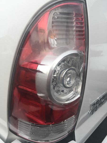

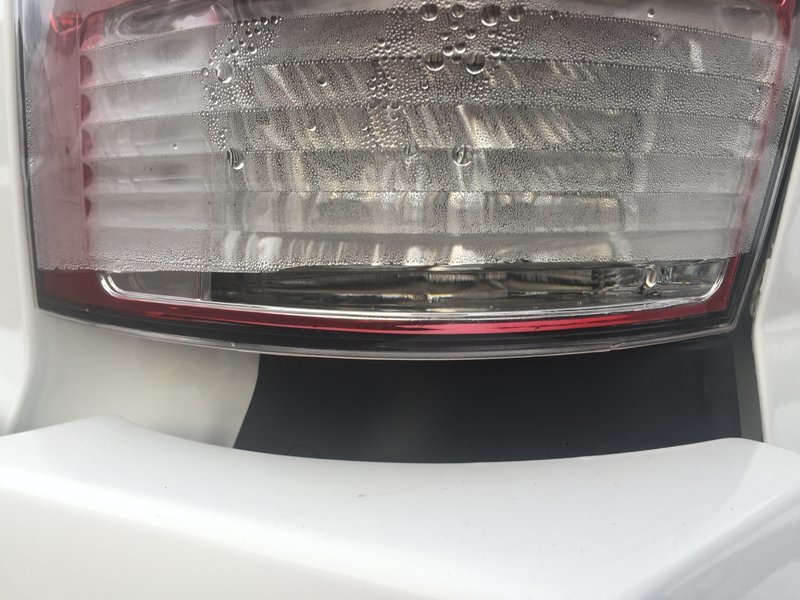

    I have a lot of condensation and water. Can I break the seal and reseal? How would you go about resealing a taillight anyways?

    Installed by a body shop last winter

    Anything is possible, but it looks like it's going to be much easier to simply buy a new tail lamp.

    look up the black headlight mod (BHLM) people break the seal and reseal headlights all the time.

    Use a blow dryer through the lamp socket holes to dry it out; then use clear vinyl or silicone sealant to seal every seam you can find between the housing outer cover and body.
    Or just buy a new set of '08 style non-"fast and furious" lights from here for $83...

    Mine has condensation for three years now and still works fine. It's cracked at a seam.
