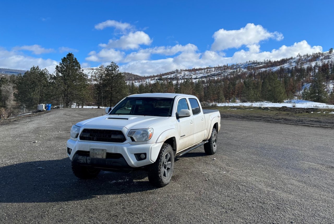

    I am spinning my wheels (literally) on how far these rims will stick out on my truck. I want them to SLIGHTLY poke but nothing too aggressive.
    Looking at the Pro Comp 7069 7983, 17" rim, 6x5.5 bolt pattern with a -6 offset.
    Picture of my truck with the current set up. But I need new rims!!!!
    Can I see pictures of these rims on your truck?! Wondering how far my -6 offset would push my tires outside of the fender flares?!
    Thank you!!

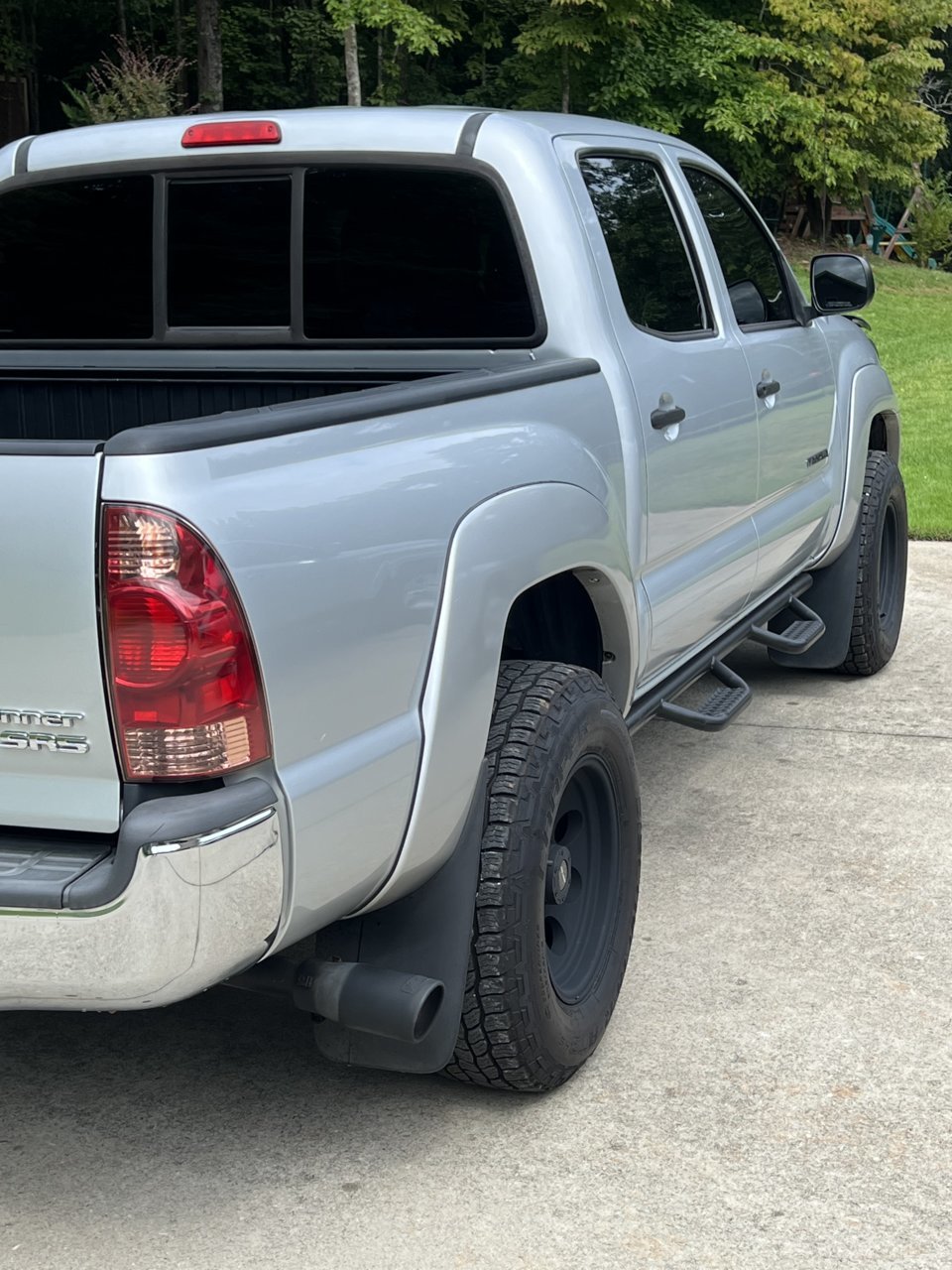

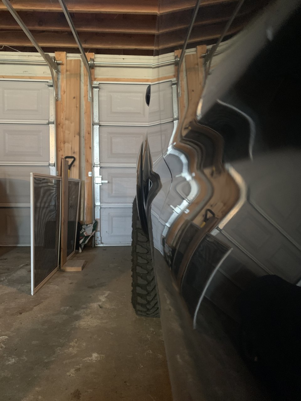

    IMG-1532.jpg IMG-1531.jpg IMG-1531.jpg backspacing is just as important as offset...so thats my first question, whats the backspacing? I have Fuel Revolvers at offset of -1 and they barely...and I mean BARELY poke out...

    so, -6 is going to poke out a bit further than mine, not much though I have 5 inch backspacing. I have seen people using -10...so..you're not frogging them at -6

    to add I also have 265 75 tires..

    If theyre the same backspacing, they will be 6 mm wider, as in sticking out 6mm more than what you have now, so like 1/4 inch or so

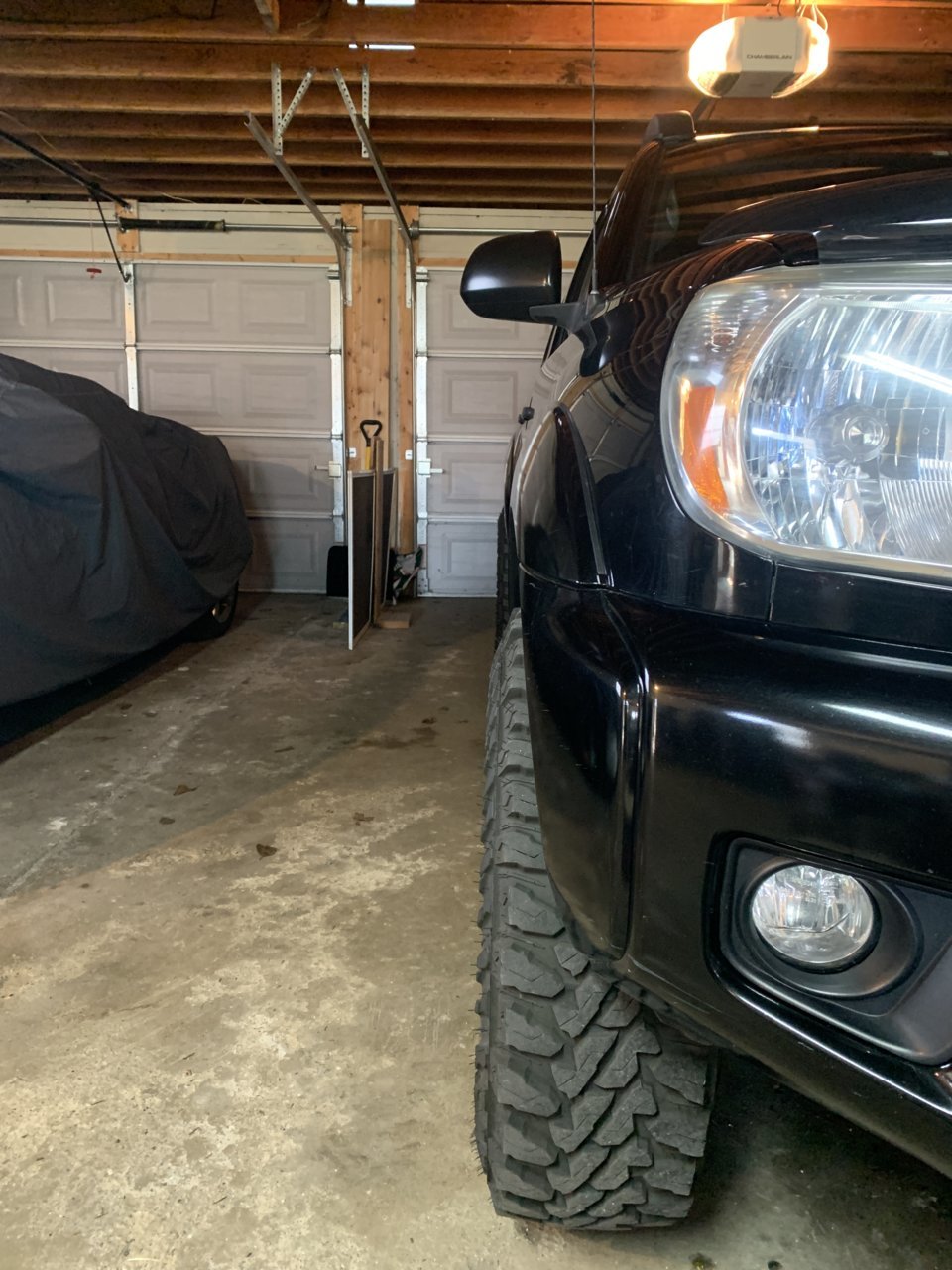

    These are 16x8 but have -12 offset. Hope it helps a little.

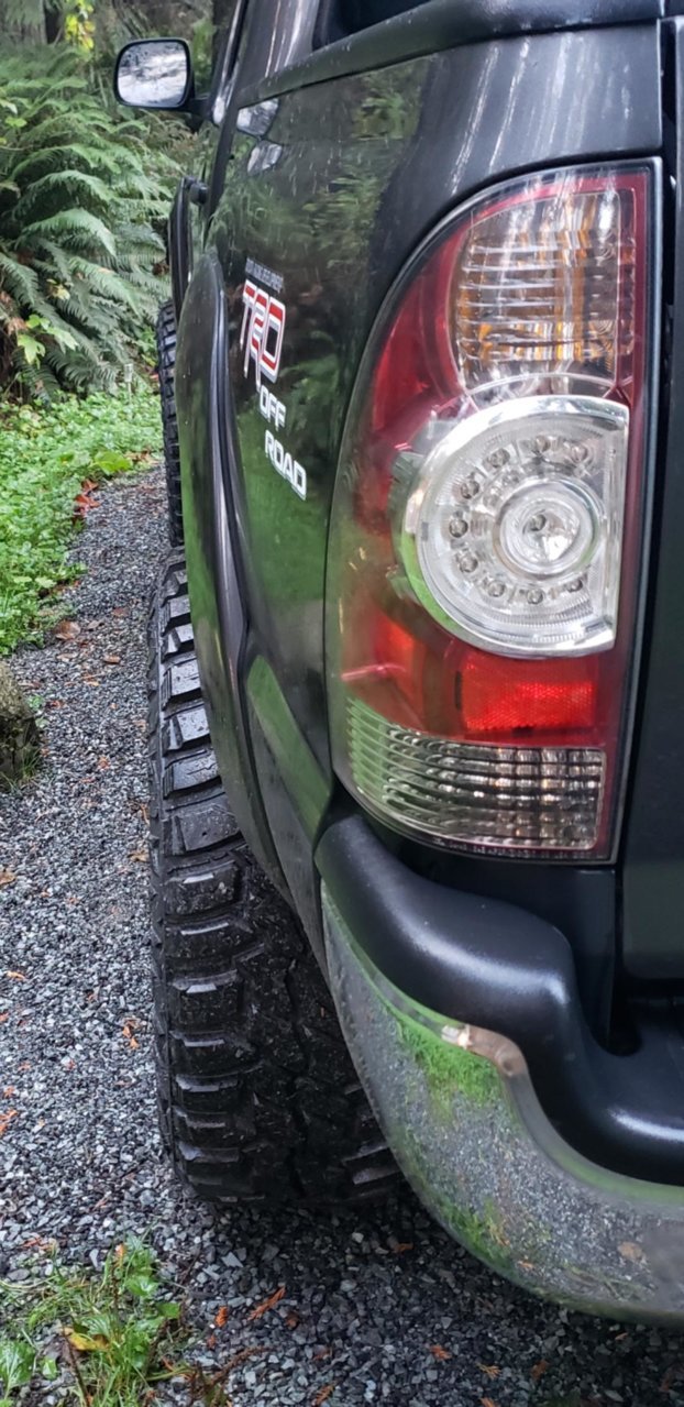

    6" Pro Comp lift KMC 17x9 XD137 FMJ Wheels 35" Mastercraft tires Custom Bilstein extended length adjustable coilovers 700lb Eibach springs Bilstein rear shocks DV8 Off Road front bumper Custom skid plates/armor Smittybilt 10klb winch Cali Raised LED sliders Cowl air induction ABS kill switch Rear air ride suspension Trailer plug relocate Clazzio leather seat covers Various lighting mods
    17x9 -12 offset
