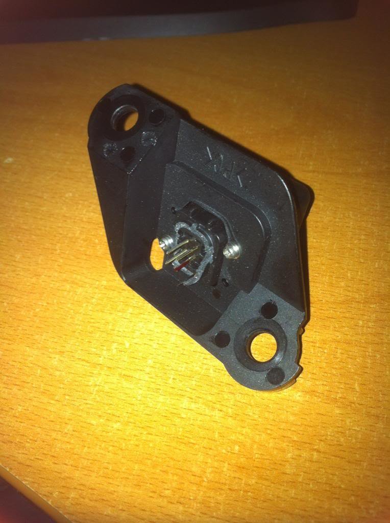

    An alternative is to shave down the 2010 camera to fit the 2014 connector, as shown here:
