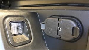

    I believe by 2020 all V6 equipped trucks came with the towing package as standard equipment. If yours does it should have a plug to the left of the licence plate like this:

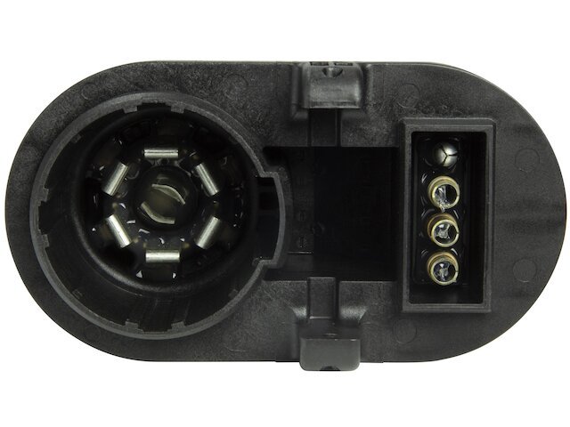

    Inside view:
    The right side has 4 prongs and is used for lighter weight trailers generally below about 3000 pounds.
    The left side has 7 prongs and is used with heavier trailers equipped with electric brakes. If your boat trailer has this connector you will need to add a brake controller to your truck.
