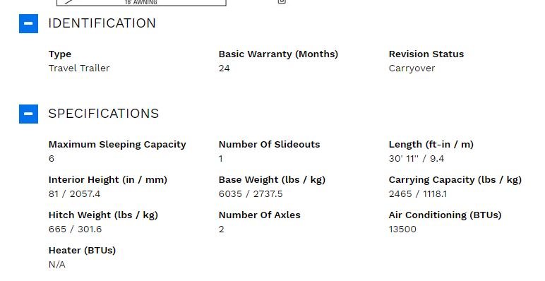

    I have 2022 Tacoma Sport and I am thinking to tow my 31ft trailer. Is that possible?

    we have to be able to think about it in more of a practical sense. A second-generation Tacoma (2005-2015) as a towing capacity of 6200 pounds. A third-generation Tacoma, (2016+) has a towing capacity of 6800 pounds. Not to mention that the tongue weight capacity is 640lbs. The trailer that you are inquiring about has a base weight of 6035 pounds and the carrying capacity, fully loaded, is 2465 pounds. And if you look at the aspect of the tongue weight, the trailer is already over that tongue weight not being loaded and when you put more weight into it, the tongue weight will go up in your truck would be dragging on the ground. If you fully loaded the trailer, you could technically tow it, and it would be feasible, but you deftly wouldn't want to. It also depends upon how far you are going with the trailer, how much load you are going to be putting not only on your frame but also on your transmission, and whether or not you would want to put your truck through that on a consistent basis. Is it feasible, anything is doable. Is it recommended, definitely not. You also have to take into account the trailer itself. Since it is a midsize truck, the weight of the truck is much less than a full size truck and the aspect of the trailer, being affected by speed, bumps, and also wind, would also make it very dangerous for you to tow it.

    Dry weight is basically at your max towing weight that is not including wind shear drag. 31’ is long and the tongue weight is close to your trucks payload after adding your weight.
    Simple answer is: NO! You shouldn’t.

    I wouldn’t. The rule of thumb I hear a lot of people give is aim for trailers with a dry weight less than 60% of your TWR. That’s so you get at least some extra wiggle room when it comes to extra gear and payload.
    With that trailer the advertised weight is about 6030, which you can really expect the actual weight to be a couple hundred pounds heavier. You add water and extra gear there’s a good chance you might go over your particular truck’s limit. The tongue weight alone is already over the max rated.
    A Tacoma is imo a really good tow vehicle for what’s it’s rated for. This trailer seems too much though. My advise would be to take the time to learn all the truck’s weights and limits and find another trailer that’s falls within them much like others have already suggested.

    I did the homework recently as we just recently purchased a travel trailer. In my instance, the dry weight a bit over 4200# for reference. With that, doing all the maths including taking it to a certified CAT Scale to weigh each axle, laden and unladen, I come in safely under all the limits, including GCVWR. There is nothing about the travel trailer OP has posted specs on that comes remotely close to being safely towed by a Tacoma. An F150 or 1500 style domestic might be shy on the specs, too.
    So....NO! Don't attempt it!
