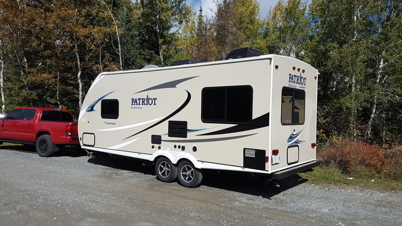

    I tow a Coachmen 204RD that comes in around 3900lbs dry with a GVW of 6000lbs. I also have the 6 speed manual and have no issues. Good choice on the manual. A weight distribution hitch will be mandatory and you wont need to add to the rear suspension. Just make sure you work out your GCVWR. With me and my wife, little pup and loaded we are under by 150lbs. If your not sure what GCVWR look it up and do the math to be sure you know where your at.
