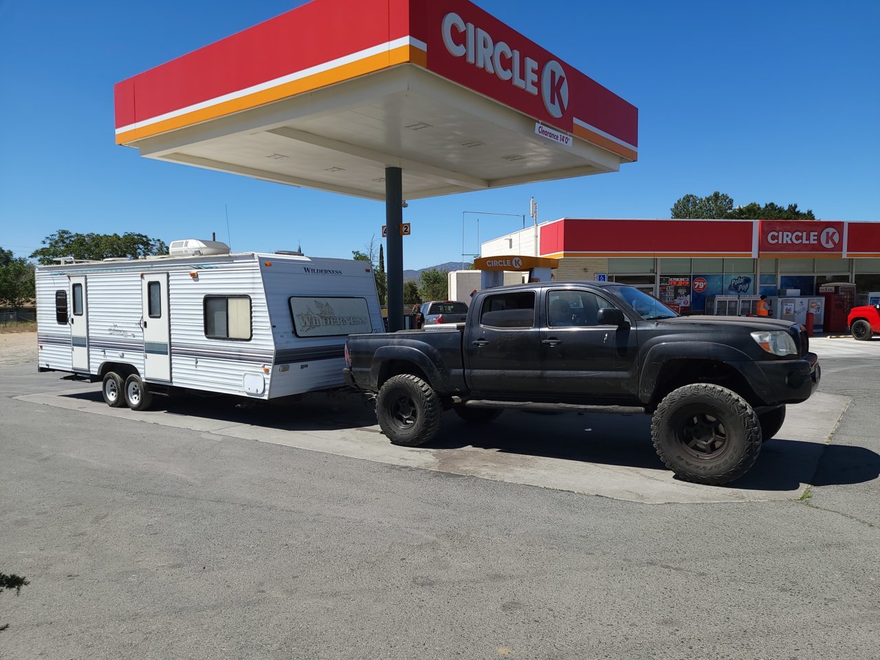

    This travel trailer weighs 5,080 lbs dry. 2006 PreRunner, 4.0L, auto. With the exception of the blackwater and greywater tanks this 26' travel trailer was empty when I towed it. I towed it 140 miles through mountainous highways and on the freeway. My trucks brakes have been upgraded and the rear ring and pinion swapped to be over-geared slightly. I didn't use any trailer brakes or weight distributing hitches. The biggest issue I ran into with my 8"+ lift towing a travel trailer was cross winds and when that happened I kept it at 45 mph, otherwise it was at 55 mph. Overall it was an easy tow.

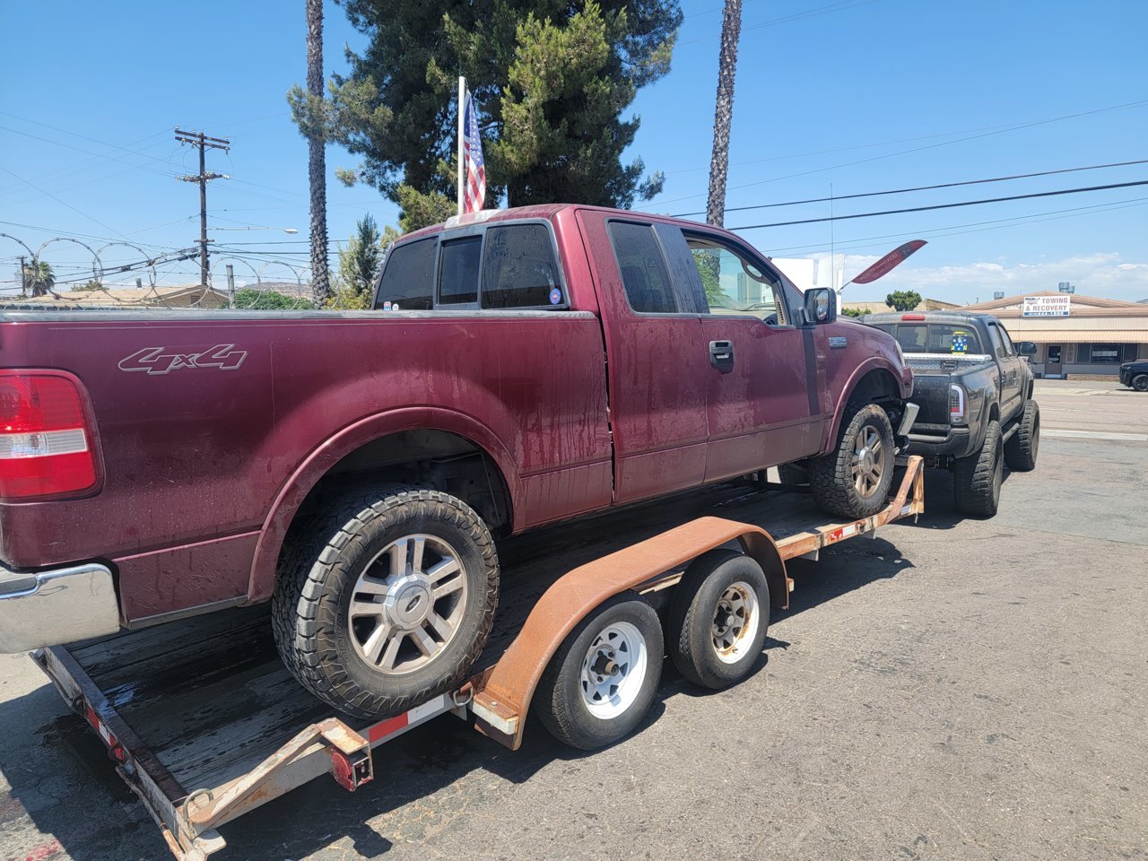

    This wrecked F150 weighs 5800 lbs. The Trailer it's on weighs around 1,400 lbs. 2006 PreRunner, 4.0L, auto, lots of brake upgrades and slightly over-geared. I towed this package around 6 miles. It was a total nightmare. The ABS kept kicking on while braking as I approached red lights. Once I let the ABS do its thing and I damn near rear ended a car because of it.

    Do you have that pit pull stance or Cali lift on purpose, or is that sag from the trailer? If the latter, your steering and front brakes are greatly diminished. And no trailer brakes, huh? Don’t you have a dad to slap you over the back of the head?
