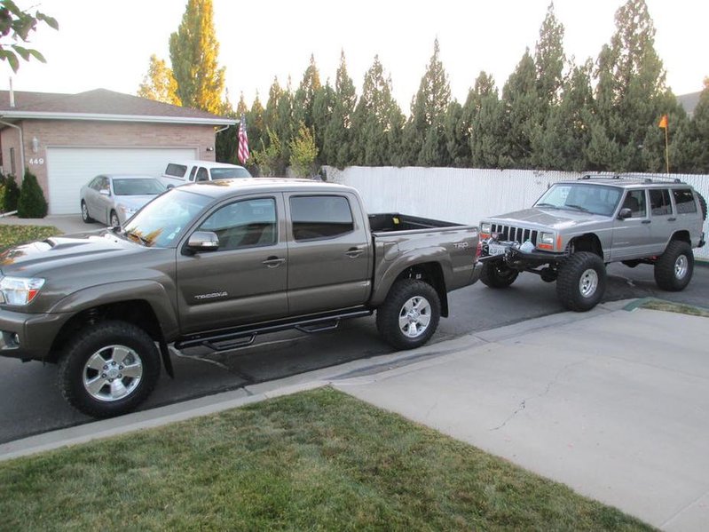

    I towed this from CA to Moab and back at 70 to 80 mph with no problems!

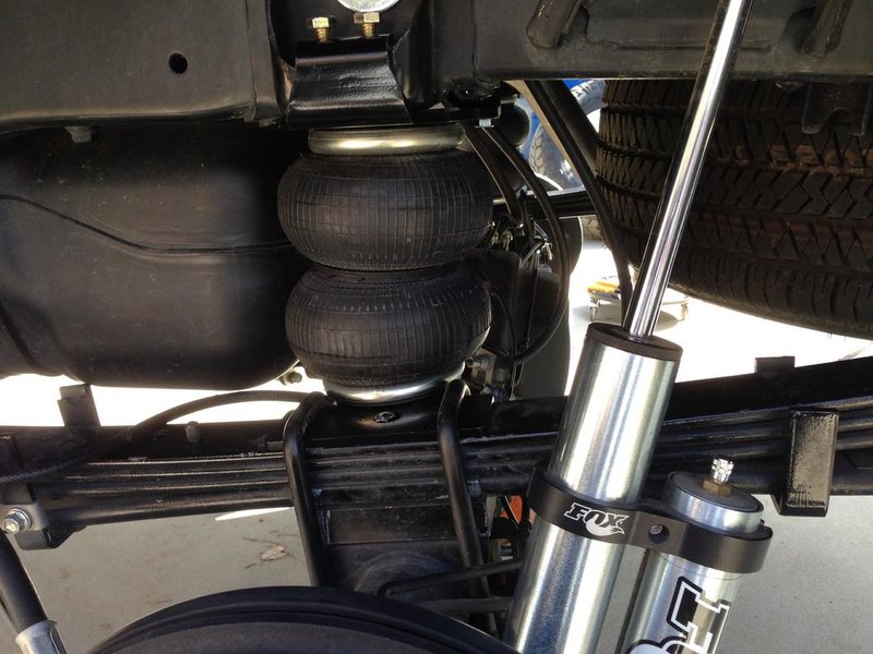

    Also added bags.
