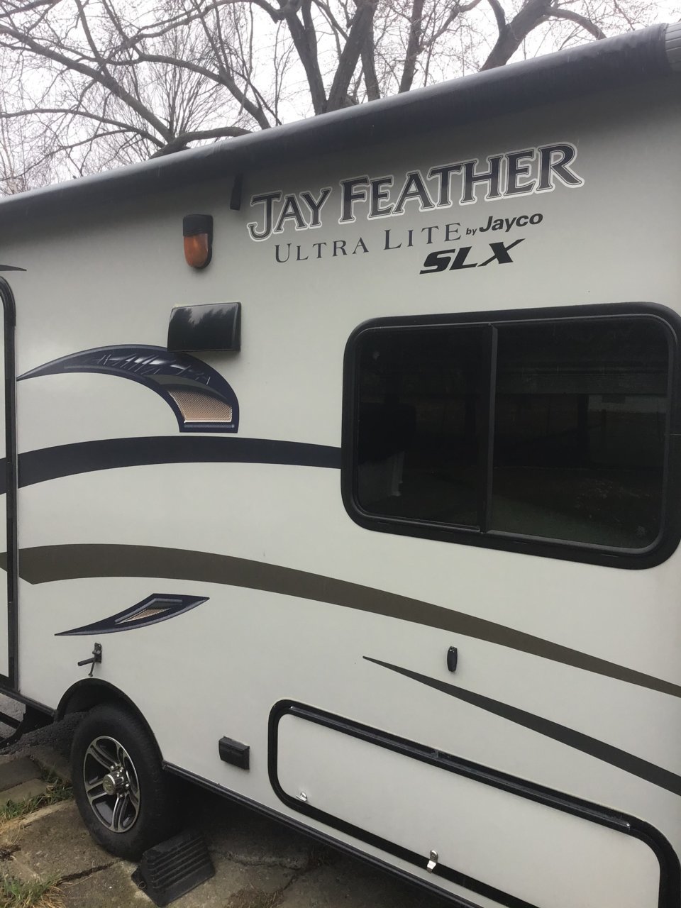

    Try a Jayco Jayfeather . Sleeps 5-6 My Tacoma did not have a tow package ,I added the hitch and transmission cooler . Brake control for the trailer and PowerStop rotors and pads up front . I pull this with all my gear and firewood no problem.EDACD6B5-5169-4C17-AC37-841C53A39CDD.jpg60F2DD96-A24F-4C61-8F87-FCE79CAA367A.jpgits one of the hybrid models . 16’ until you open both ends for sleeping then it’s around 24-25’ .
