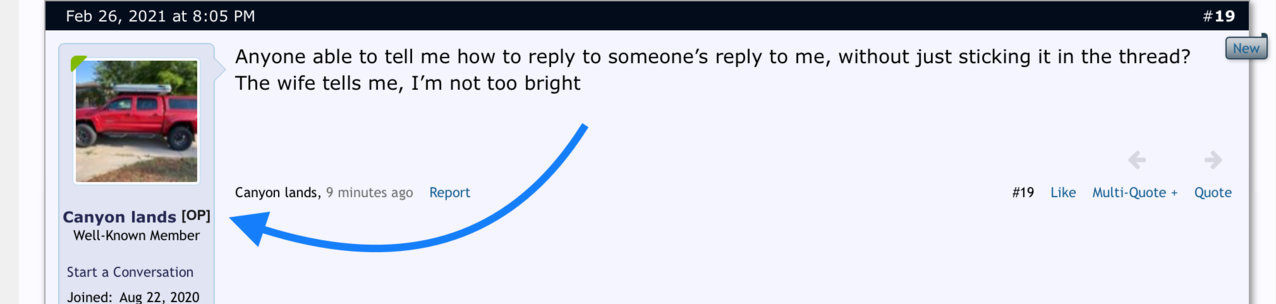

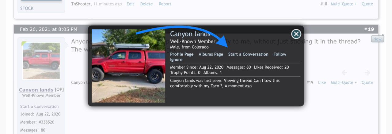

    Click the persons User Name you want to respond to.
    Then click - Start Conversation

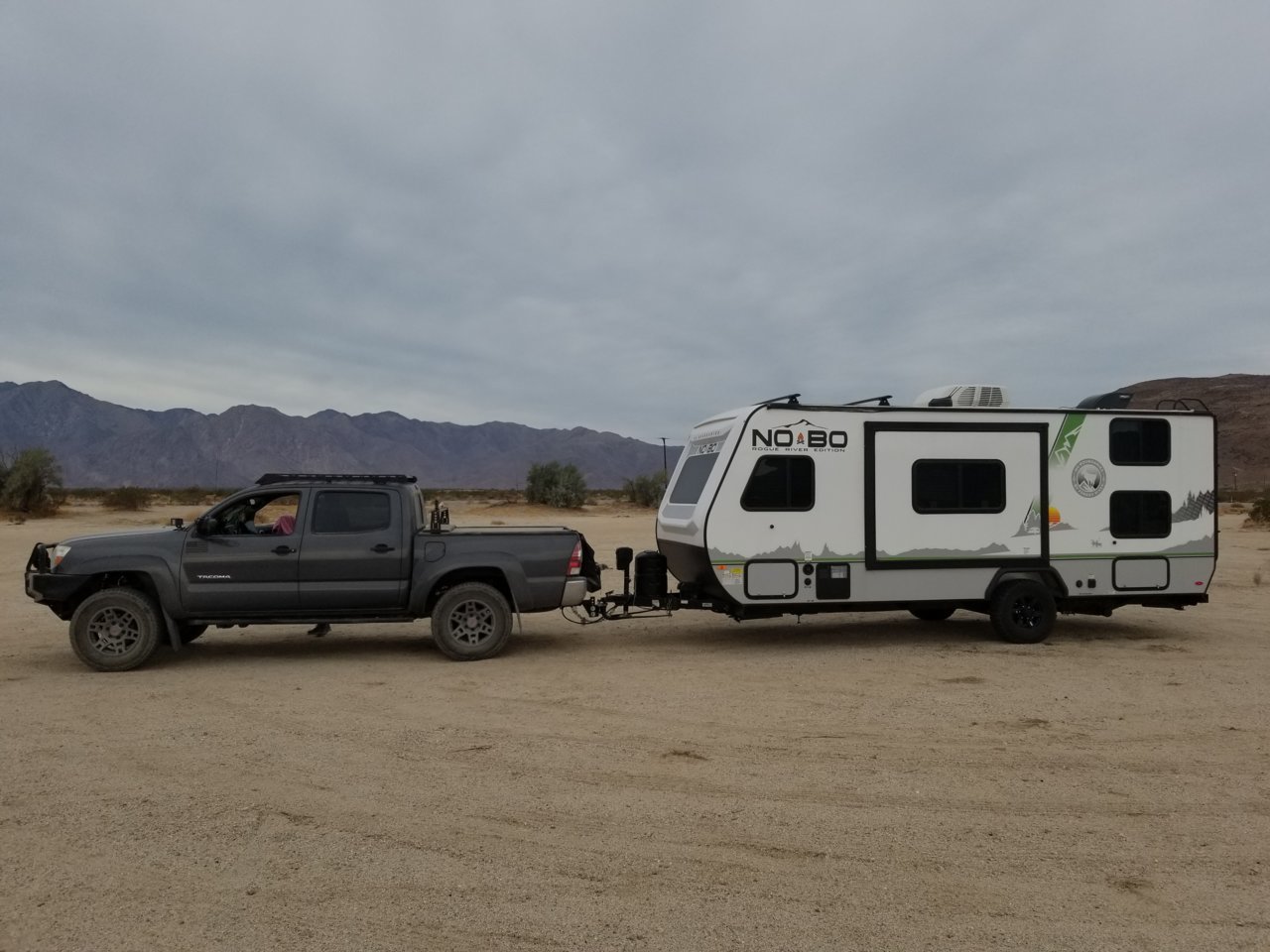

    I honestly think you'll be good. Just take it easy, and don't be in a rush. Your trailer is much smaller, lighter than mine and the Tacoma should tow it no problem.
    I towed a 2021 Forest River No Boundaries NB 19.8. Comes in at #4000 dry and #5000 loaded.
    I went from North County San Diego through Hemet, Lambs Canyon grade to Beaumont onto the 10 hwy ending up in Palm Desert. Then from Palm Desert, to Salton Sea, and camping in Borrego Springs. We dry camped for 3 nights then returned home via the S22 Montazuma grade (one of the steepest grades in SD county) through Pala back into North County SD.
    This was my first trip towing with the Tacoma. I usually tow with my full sized 2002 GMC Sierra 1500 with the 5.3L v8 LM7 engine.
    I think the tacoma puts the power down better than the GMC. The 5 speed in the Taco has better gearing than the 4 speed in the GMC. The GMC for sure doesn't get pushed around as much as the Tacoma did especially in the high winds of San Grogornio & Morongo.
    GMC has a bigger bed and bigger payload so I could have packed more stuff like firewood.
    The Tacoma has a Hayden 679 trans cooler, which is an absolutely necessity to tow anything in the Tacoma. I saw trans temps of 221*F through Montezuma grade when it was only 58 *F outside.
    From my experience, I think a Tacoma should tow your #3300 trailer no issue. Just have WDH and brake controller. Be smart about not rushing and enjoy the trip.

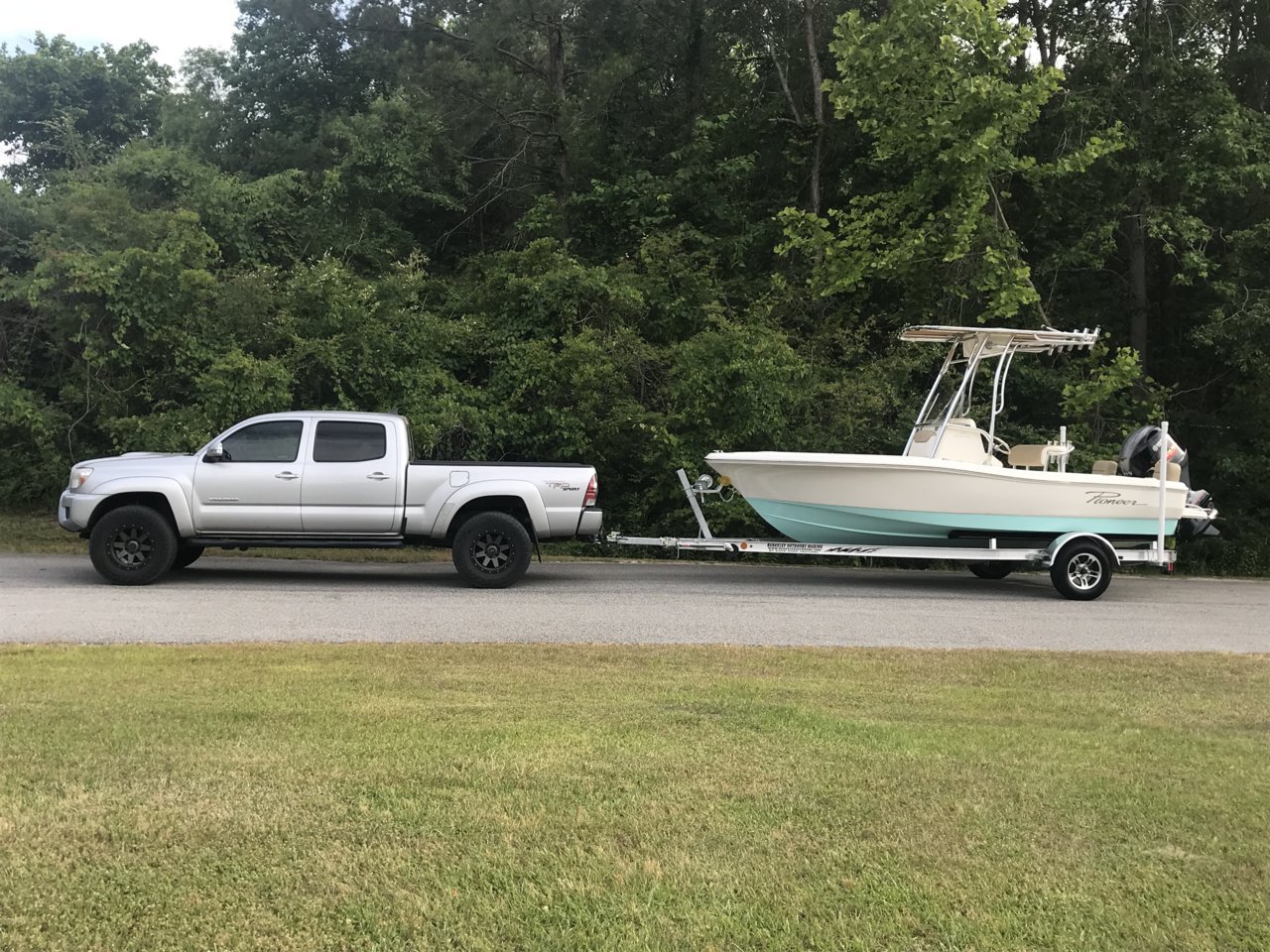

    Here is what I tow and I have 33’s with stock gearing. :burnrubber: 18 ft center console bay boat.
