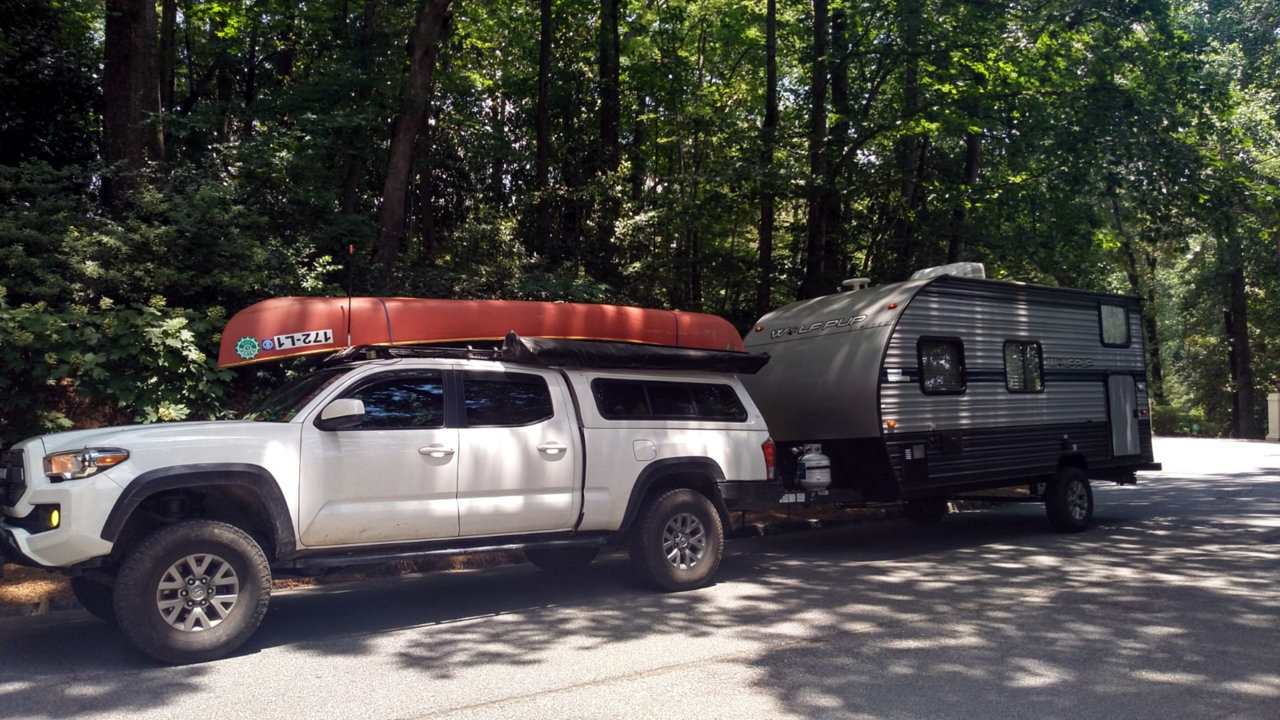

    Yes, definitely. That's a little trailer and well within responsible towing ranges for the Tacoma.
    My truck is over 6k lbs with all the mods unloaded and I tow a Forest River Wolf Pup 16BHS - https://forestriverinc.com/rvs/travel-trailers/wolf-pup/16BHS/1330 - which is lifted and running truck tires - with zero issues regularly. I've owned the trailer a year and already towed over 10k miles.
    I have Sumosprings, they help a lot. You'll want a weight distributing hitch (WDH), sumosprings, or airbags. One of the 3 - definitely not all 3 needed, seriously just pick one. I only have Sumosprings and have zero complaints.

    Absolutely... Comfortably I'd think. I tow a Coleman 1805rb with my 2016 ORDC. Ours is around 4000 lbs dry. We do have a wd hitch, brake controller and Timbren bump stops. The Taco pulls it fine albeit a little slower against a strong headwind or up into the Rocky Mountains. You'll learn to use s mode to help in certain towing situations.
    Looks like a cool trailer with nice floor plan. Get it, get out and enjoy!

    DCLB + Camper + sleeping platform + armor = CHONKY!!! :benchpress:
