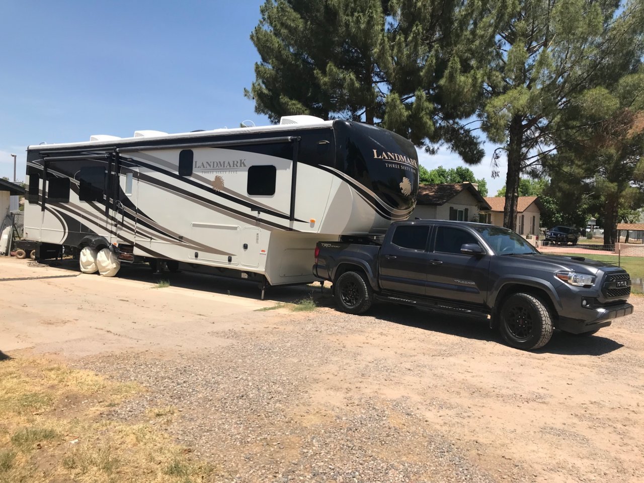

    I have a Gashole
    You mean like this :eek:o_O:boink:;)

    s.wilson
    s.wilson Less talk, more tech
    Jun 26, 2016
    #190603
    173
    Morgan Hill CA
    1988 4Runner 3RZ, 2019 Tacoma TRD Off-Road
    TLCA Member #5261
    Awesome picture. I sure hope it was taken for a joke

    KissmyTaco
    KissmyTaco Well-Known Member
    Feb 21, 2017
    #211309
    356
    Eric
    Phoenix, AZ
    2017 Tacoma MGM DCSB TRD Sport
    I have a Gashole
    maybe :notsure:
    Yes it was. Figured I screw with the towing forum a bit a while back.:rofl:

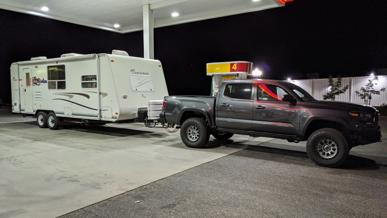

    I ended up buying a used Coachman 24QRB this weekend. Slightly heavier than the one you listed above. 3818 GVWR, 470 tongue weight.
    I had already been preparing my truck for this, so I already had installed a brake controller, Dobinson's 'medium' leaf springs, and Firestone air bags with Daystar cradles. I already had a weight distribution hitch.
    I was pleasantly surprised at how well the Tacoma handled the trailer. The upgraded suspension was money well spent. 20 psi in the air bags had my truck sitting level.
    The truck was very happy cruising at 55-60 mph, and when I hit some big grades over Pacheco Pass, speeds dropped to 45 mph.
