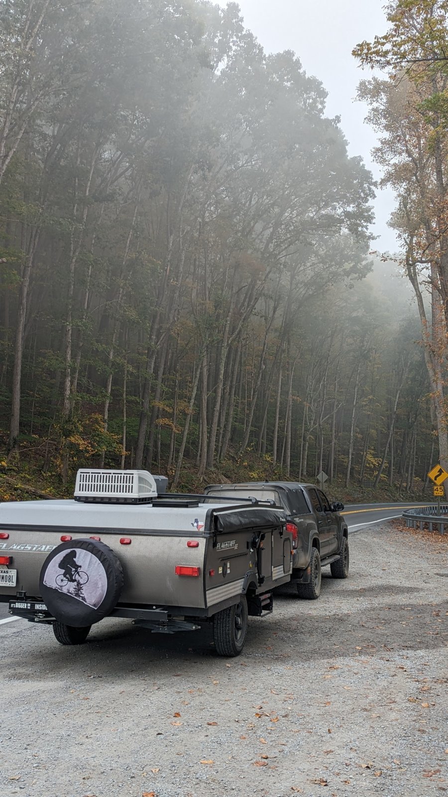

    Towed a 5klb TT about 10k so far, did 2k miles last week.
    https://www.tacomaworld.com/threads...4-700lb-travel-trailer….760812/#post-27122598

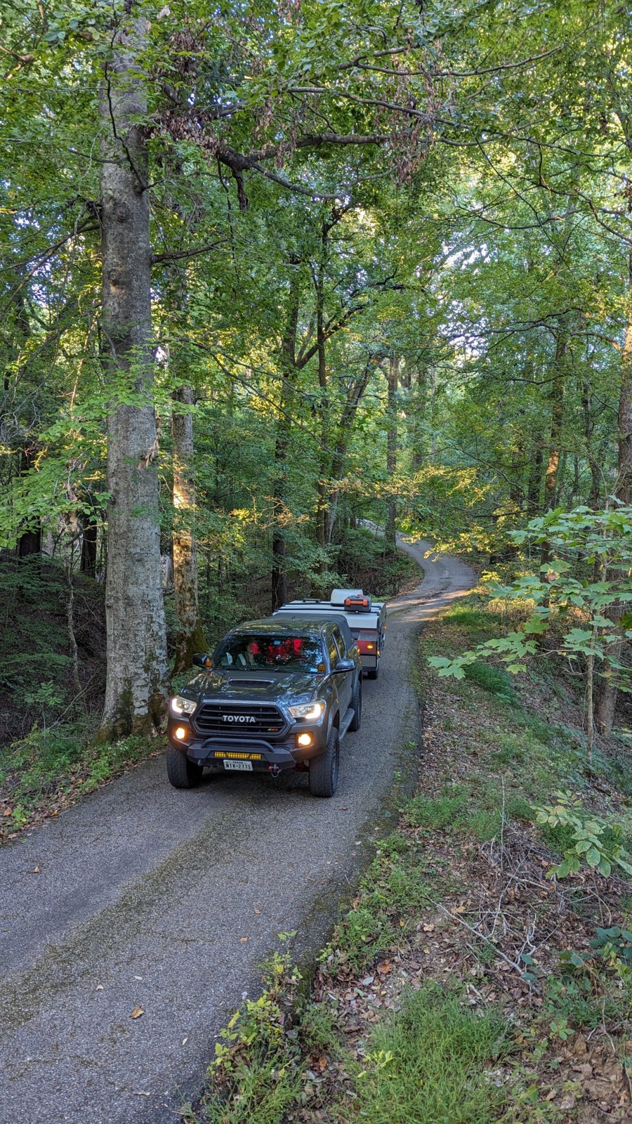

    I just wrapped up a 3500 mile trip in this.
    If you're touring long distance, you either want it to be under 17 feet hitch to bumper, or you need a diesel tow pig. If you're touring the US and want to see something besides interstate traffic and RV park style campgrounds, you need the former and not the latter.
    I saw many combos like what you're asking this week. I only saw them on the busier roads and they were annoying the 18 wheelers due to their inability to maintain any kind of speed. Any hill that forces the big trucks to crawl up, the v6 gassers pulling a double axle were crawling even slower. It looked painful to watch.
    But more importantly, I didn't see many twin axle trailers on roads like these:
    Dirt and loose gravel, tight switchbacks, one lane mountain roads, 10 foot wide wooden bridges, places where the people who would rather sit in their class-As and watch satellite TV won't even dream of. The places that are the whole point of touring the US, where you see something unique, where you aren't buying the T-shirt from the nearest truck stop.
    The bigger trailers are more comfortable, but the smaller trailers have more fun. Get a big trailer if you want to sit 50 miles from home and burn firewood. Get a small trailer if you're wanting to explore.
