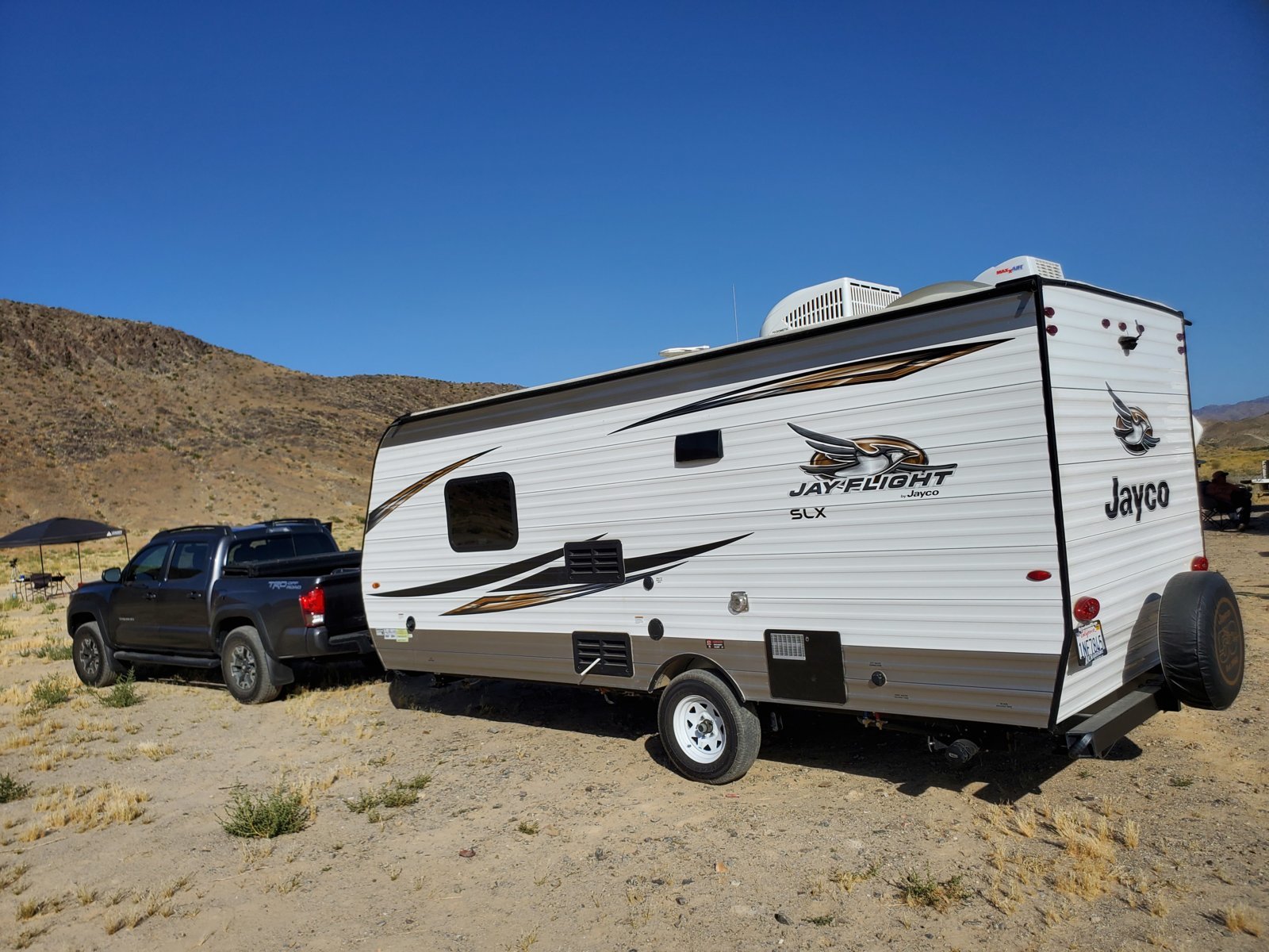

    @danir1 I was one asking the same question you did - got talked out of a larger travel trailer and into a smaller one:
    Jayco 195RB, single axle, 3000lbs UVW, 3750 max. I am reasonably certain I exceeded the max weight and my Tacoma payload by hauling my generator, fuel, water, and a lot of "extra" stuff in the trailer.
    The Taco pulled it OK, but did struggle going up grades - I would see 4000+ RPM as the transmission would drop to 3rd then 2nd gear. Transmission temps as reported by my Scangauge would climb into the 240° range as well, and wouldn't come down until I got over the summit and was able to start coasting down the other side.
    Headwinds or crosswinds were white knuckle times. The Taco would struggle if the winds were strong. Overall, I would get 11-12mpg max while towing. I moved up to a Tundra earlier this year, and it had zero effort towing that same trailer, and was able to accelerate/pass other vehicles going up steep hills while towing - it's like the trailer wasn't even there. Night and day difference.
    I see the trailer you referenced has a loaded weight of 4849lbs. That's a lot for this truck. You probably COULD tow it, but as others have said, it won't be fun and could even be dangerous depending upon your setup.
    As others have said, the recommendation here is to not do this - at least for a TT of this size.
    Junkhead and RustyGreen like this.

    @danir1 that's exactly the trailer I had in the above picture, the Jayco 195RBW.
    Great little trailer and it served me well. If you get it, run over to the Jayco forums and look up my mod threads there to customize your new trailer.
    The Taco will tow it just fine. :thumbsup:
