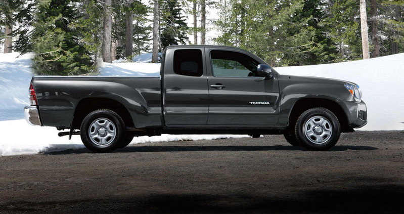

    hi i have a 2015 toyota tacoma 2wd 5spd. I have a factory installed class 3 hitch. Its says its rated at 3500lbs toeing capacity.
    Im looking at purchacing a 2016 white water retro 177 camper trailer. Its just 18' lomg and registered at 2800lbs dry weight.
    I live in northern ontario canada, and i seem to be the only one in my area with a 2wd tacoma. So ...no one can really give me advise as to if i can tow this unit or not...
    My question is...can i tow this no problem? Amd what can i do to my truck to make it easier without voiding my warantee?

    too close for my comfort, unless you are not concerned about longevity. Remember 2800 lbs is dry, not that you will be towing a full water tank etc. but, clothes food BEER, toys, it all adds up quick

    Thanks. I also have a gmc sierra, so i know that will not have a problem, however its just a reg. Cab. My tacoma is an access cab, so a bit more storage....

    that Regular cab GMC would tow it fine, but thats pushing it for the Taco...
    Really nice 5lug taco btw!
