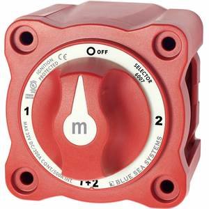

    I was going to install a dual battery system in my new-to-me 2004 taco by slaping one of these through the firewall or even under the hood:
    A simple marine switch like most every boat i owned has had. and 3 vehicles has had...
    Then when looking for confirmation of my plan on tacoworld i see no one doing this. Everyone has fancy electric controllers for dual batteries. I feel like a caveman:
    "WHAT THOSE SHINY BLINKY BLINKY THINGS ON ALL YOUR TRUCKS? "
    "WHY YOU NO LIKE BIG RED BOAT SWITCH?"
    Are the computers in my 2004 tacoma going to be fried if i just wire the batteries with a marine switch? I figured '04 was old enough.

    Truck boat what's the difference? It will work for 2 batteries in a truck but remember all memory leads need to go to the battery before switch or lose all your memory.ps should run a infuse to memory wires just in case of a overload.why do you want or need dually batts?

    No reason the switch won't work. It's only "claim to fame" is NO exposed spark since they are intended for the bilge area where gas fumes can accumulate. Not exactly an issue in a truck. Make sure what you choose can stand the current the starter will draw.

    I like this idea, if I'm understanding this marine device correctly. You just have to remember to manually switch from '1' to '1+2' occasionally.
    The simplicity of this appeals to me. ( I also like manual locking 4x4 hubs for the same reason :D ).
    Another advantage: if you develop a parasitic draw, setting it to 'Off' while parked sure beats
    disconnecting the battery, until you can track down the reason for the draw.

    Yes, that is why i like it. I have used it on small sailboats and motorboats for years. We had a pair of old vans at a summer camp that i worked at which were frequently dead after 1 week of no use. Groups of kids would get stranded at backpacking trailheads without food. So the maintenance man and i did this to them and we never had a problem again. Since you can turn off the battery while hiking it is 2 times as useful as those jumper kits, and way safer as it is not rolling around in the cab.
    I am glad the folks on this forum [EDIT: see link below] say it is safe to ignore the claims that switching from 1 to both to 2 while running will fry computer controlled systems. But my disclaimer is the companies making more complex chargers claim there is a risk. See the video above [EDIT: below] from the pirana sales man.
    I have yet to ensure one can use a deep cycle as batt 2 and a normal as bat 1, but i think that is addressed in the link to the pirate 4x4 writeup linked above [EDIT:below]. I pan to use it only to maintain a second backup batt. I no electric accessories in my camper aside from a ham radio and a winch (only needed in emergencies).
    I do hear that accidentally switching to 'off' while running is bad, but so is tripping the solenoids in a configuration that turns off both batteries while running. If anyone can confirm what damage might occur to the truck when switching to off I would love to hear it.
    If you find a good place to locate it please post here. I found my firewall to be very busy and i do not want the "full juice" cables in the cab.
