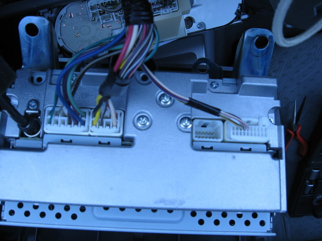

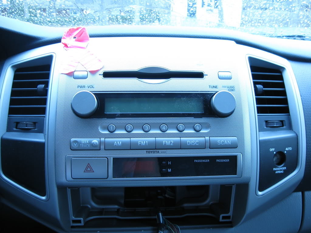

    Hey guys I have a 07 access cab v6 prerunnerr and I am wondering if my oem radio head will work with a Sirius radio,ipod hook up, or something of that nature. I have done some research and I believe that it is compatable but I'm not entirely sure. I believe that it is a non-jbl bc I haven't noticed any markings like jbl loves to to on all of it's equipment. Also I do not have a aux in button. I can post pictures a little later if it would be helpful

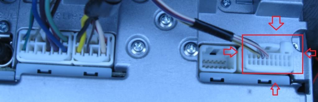

    and also can anyone tell me what this goes too? and i do not have steering wheel controls

    there are interfaces that will allow you to have aux.....i used a product called "isimple" works great ...it plugs into the empty slot shown in your pics

    press the cd button twice and the option comes up...depending which interface you use it will say aux or ipod.....you can buy the isimple one at best buy....if you wanted to add satellite radio you only have the option for xm if ur going through the stereo but if you add an aux to the truck you can add xm or sirius with an external unit

    I see what the problem is.....try pushin the am button that should give you the option

    for that to work your head unit must be SAT ready, its the first requirement listed under "vehicle specific information"
    looking at your pics your radio is NOT satellite ready
